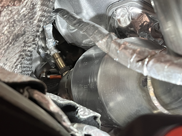

Well, I got a set of the faulty SPD downpipes with the upstream o2 in the wrong spot on the drivers side pipe, of course. Guess I should have gone Fenfab after all. Luckily the shop I am at is equipped to tap and weld a new bung on for me so the job will still get done, but very annoying to have to pay to modify a brand new set of DP's. tempImageWEsmbw.png

What doesn’t fit? It looks like you have the sensor in place or is that after the modification?
That's the sensor hitting the engine, I couldn't get a photo of the flange not mating 100% with the sensor also in the photo. This is a pre-mod photo.
