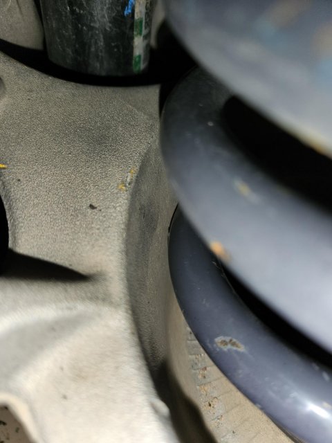

The noise on my rear springs would come and go depending on whether they were wet or not. The only real solution is to pry the spring away from the lower control arm seat edge, or replace them with a different spring set.
In all of the conversations I am seeing here with buyers with the Lethal springs is measuring height and not if the rear springs were modified to change the way they center themselves on the lower coils. That later is what I am most interested in, besides them not being as low as advertised both front and back.

So Cajun What is the diameter measurement of the spring at the lower coils? Assuming that's the issue since I hear they don't center themselves far enough away from the side of the lower control arm? I'm trying to figure out where to measure and look before actually going through the install process only to find out there is a problem. I'd rather swap out the springs for a new set before getting that far into it.

I think it is both.
Both springs are about 5" in diameter in the center but it looks like the difference is the second coil from the bottom on both. The factory one looks to wait until the 3rd coil before it goes to the full 5" diameter where the Lethal spring goes to the full diameter on the 2nd coil.
I know that once you have the spring set in the isolators where it wants to center itself, you will need to pry the spring away from the lower control arm side on the tire side towards the center the car.
I wish I would have taken a picture of the Lethal springs side by side to the factory ones before I installed them. Can you take a picture of the Lethal spring with the flat side of the spring down?
I see exactly what you mean. I'd be interested to see if they have changed the design to more replicate the OEM taper with the new run of them.
