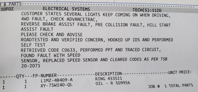

Does anybody have a copy of TSB 20-2071? I have searched online and do not see it listed. My wife drove into the dealer with all these codes active, left running for laptop hook up, and 10 days later still troubleshooting.

Took them 2 weeks but they finally changed the Front half shaft sensor per TSB 20-2071 and all good.
