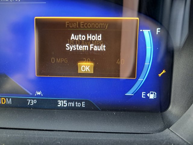

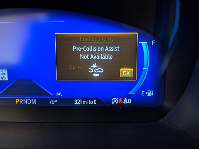

#81
Mine had this issue one time months ago. Couldn't use cruise control or any drive mode other than the normal one. Restarting it didn't do a thing, it just went away on its own in the middle of the highway that same day.

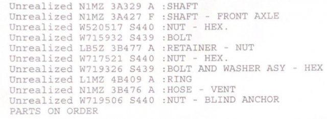

#85
Took mine in for these codes and had something to do with the transfer case and its components, which are being replaced once the parts come in.
These were the parts on order. Apparently, some of these parts are one off replacements. See attached.
267
96
Safety Harbor, FL, USA

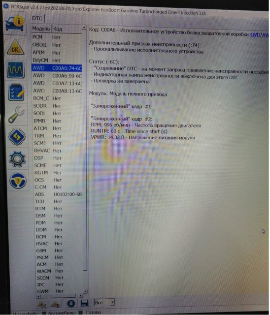

Good afternoon
Error C00A6: 07-68, the front axle speed sensor has been changed, the AWD has been updated. There are no errors, but when you start moving the car twitches, tell me what to do?

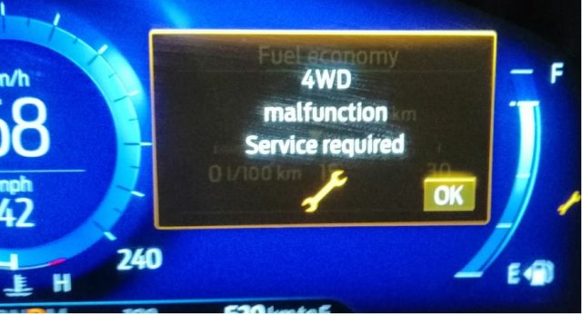

Good afternoon
I'm from Moscow, we don't have dealers. If anyone can go to their nearest dealer and find out what to do, what to repair in my car. Or maybe someone has come across this.
Ford explorer release 07.2020. When starting off, the car twitches (at low speeds). Errors pop up both during acceleration and when coasting, in rain, dry weather, or they may not pop up, but it always twitches. When the engine is restarted, the errors are reset. Errors in the application.
Thank you

The above errors recently happened to me. The AWD module was the fix.

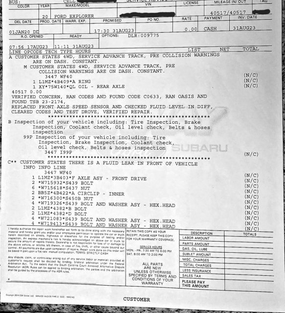

Just took my Platinum in for service today. For the exact same problem. Service advisor told me. There was a transfer or axis leak. Gave me a loaner immediately. Cross fingers its a warranty repair

The AWD module did not help, they changed three pieces, updated the firmware, etc.
Problem still exists

Today they changed the transfer case and the issue was resolved.
Everything works great -:)!!!
Table Rock, SC
2020 Explorer Platinum
Got mine back today. Had 4 repairs done. Service advisor said they kept finding things. CATALYTIC Converter, Front Axle speed sensor, Front Differential, and Front Axle boot all Replaced. Vechile still has a little jug when running. I'm a use some Lucas oil injector cleaner and see if that works. I think the Shell V-Power® NiTRO+ Premium Gasoline had water in it
