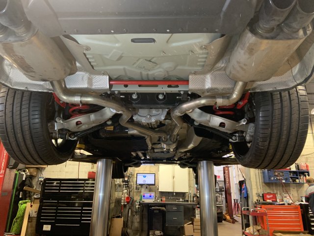

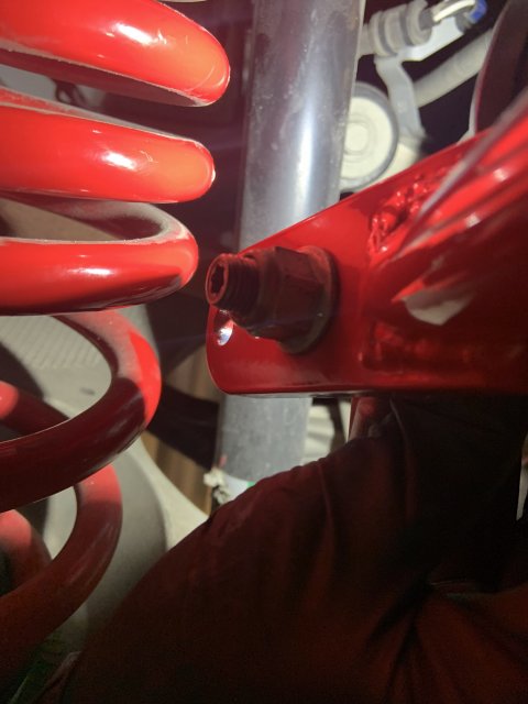

Anyone else with HR lowering springs have any fitment issues on the firmest setting with the Steeda sway bar? The end of the bar is slightly rubbing against the HR springs...my installer is going to cut that last hole off the bar to make it fit but seems like this shouldn’t need to be done...?

Your first pic looks like the bar is centered and there is enough space to avoid contact on both sides. Maybe you just need those collars that Unbroken suggested to keep it from sliding. Other pictures make it hard to tell what's what because of the camera angle.

Under the vehicle now. The first pic is the left side and the second pic is the right side. Left is hitting. There isn’t hardly any space on the right side to even shift it over to the left.

I took off the Steeda sway bar and compared it to my stock one. The stock one is almost an over an
inch wider.
4,575
5,347
The only change that needs to be made is adjust the welding jig to move the ends out 1/4” per side. Problem solved...zero cost impact.
Jshaffer3819
471
261
Kaiserslautern, Germany
#20
Exactly. It’s angled in too much at the ends.
