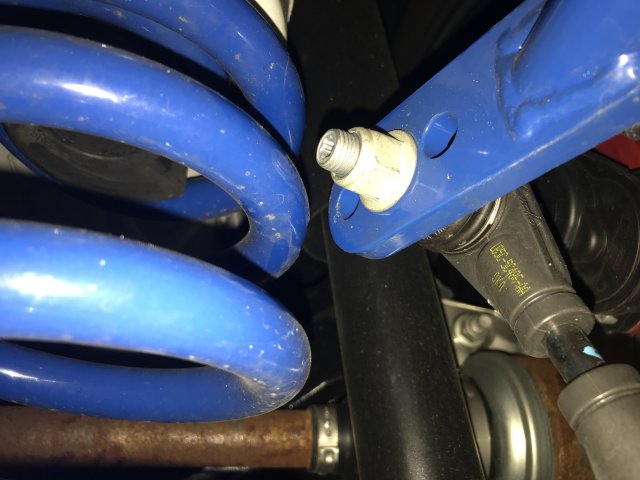

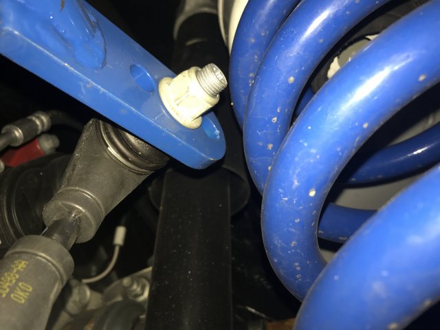

I took off the Steeda sway bar and compared it to my stock one. The stock one is almost an over an
inch wider.
I wonder if it's possible that some of their sway bars production are narrower than intended. Maybe the tab. positions are even different. Yours seem to fit much tighter than mine--as if there is no possible way it wouldn't rub. Mine don't rub and I have 5-10 mm gap on each side. I wish I took a picture of my Steeda RSB with my stock bar but I did line them up when I got it and thought they were more or less the same--yours are noticeably narrower. When did you order yours? It seems like they sold out the initial stock and then must have made more. Mine was one of the first.
Yes this is very odd. Maybe they sold me a 2019 version? Not even close to stock. I had hardly any play from side to side. I’m waiting to hear back from them but they still want measurements.

2019 has a notch in the bar--couldn't be mistaken for a 2020. I'd be curious what your measurements are. Maybe the bar itself is more or less the same and only the angled ends make it much narrower? Hard to tell from your pic. I might cut off the ends when I go to put on winter rims--if only for piece of mind so I don't have to keep looking. :)

Yea same here. I get it centered, barely, then take a tight corner and it shift just a tiny bit and starts hitting. Frustrating.

Hi TJ, I haven’t spoken to you yet but I have been working with Brian. I sent him all the pics and measurements last week but haven’t received a response yet. I have tried four different times to get this to work but still no luck. This isn’t rocket science either. I have the stock springs but not sure if that should really even matter. The width of aftermarket springs compared to stock springs is negligible. When I install the bar and get it center, using a credit card to verify the ends aren’t hitting the springs, I still can’t adjust the center brackets to be flush against the bar flanges. It moves as soon as I take a corner then starts hitting again. No idea where the disconnect is here or why we can’t get this resolved but I’m not happy with this thing and refuse to cut the ends off to make it fit. Either way the flanges won’t be flush either allowing it to move laterally. I just want a refund and have put my old bar back on. This is a simple fix. No reason the ends have to flare in so much. Just change the angle of the ends and move them out. However there is still an issue with the flanges and this thing is about 1.5 inches narrower than the stock bar. See attached. I hope this can be resolved.

For those interested, here is some pics of clearance with the Steeda springs. As you can see there is loads of room. No contact. I was in the first batch of bars as well, fyi.

what happens if you switch to the firmest setting hole? seems like that's where most of us are seeing the fitment issues...at least that's where i am..

I have always had mine on the firmest setting. No issues. I am wondering if people with issues had the second batch of manufacturing.

i only ran it in the firmest setting for a couple of hours while i was testing. but during that time i was pushing HARD, trying to get the truck to oversteer. when i crawled under to swap back to the middle hole, i didn't notice any nicks or scratches on the springs or the tip of the bar.

I don’t think the steering used will make a difference. The end of the sway bar is hitting and not the bolt. The bolt position is the only change when choosing which setting.

yup. the pics are deceiving, but the bolt is nowhere near the spring in any position.
