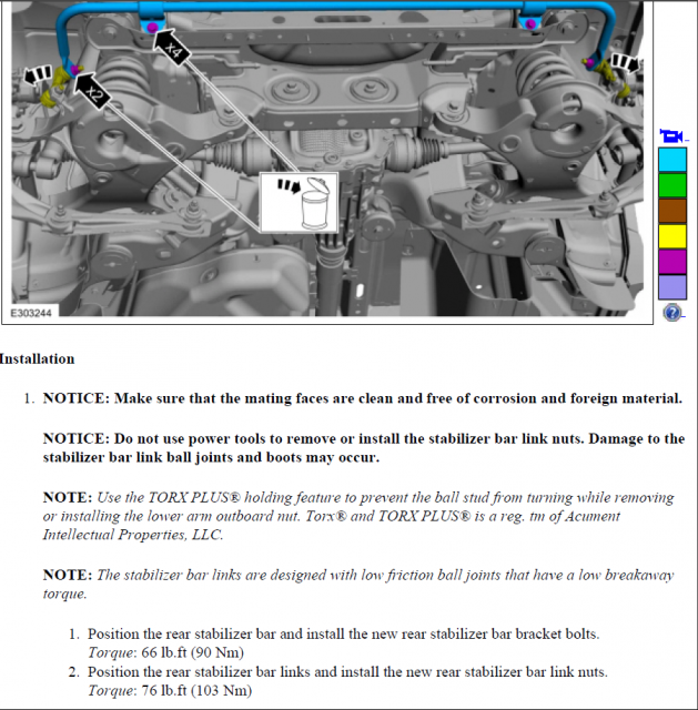

The torque spec for steeda rear sway bar is - 66 Ft lbs for bracket bolts, and 76 Ft lbs for the endlink nuts.
My question, is that the manufacturer (stock) spec too? or is the stock rear sway bar torque'd to something different, if so what?
Answered my own question. I needed to be sure for both RSB's (steeda & stock). :)
