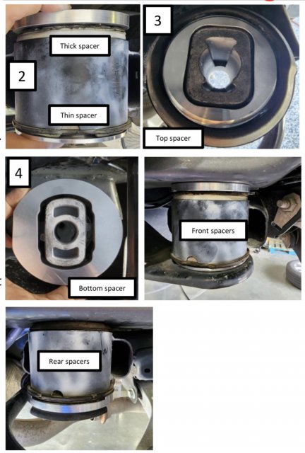

Another install done, took about 90 minutes including tool gathering and driving up on ramps. Didn’t remove the rear wheels and it was no problem, especially on my 8” lift Race Ramps. It was also necessary to unbolt the rear exhaust hangers and slide the pipes to get at one of the bolts on those rear frame brackets, which isn’t mentioned. I couldn’t care less about drag racing, but any improvements that can be made (i.e., stiffen) an IRS rear is well worth it, so I’m glad to have them in. Didn’t hurt that they were only around $200 when I bought them a month or two back.
Here’s a screen shot of the Steeda instructions that show the location of each insert as an FYI. Between their instructions and the video, it’s a cinch.
