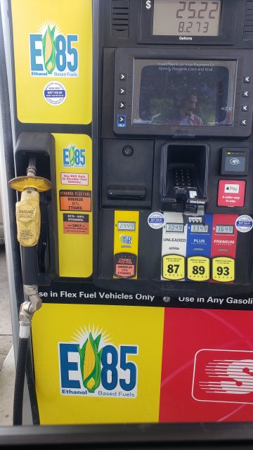

ohhhh damn, just found E85 down the street from me! I am waiting for my Thermal exhaust to show up and then I'll send my stock log to ZFG for my baseline. I do have the LMS E30 tune available, might test a tank of E30 out. I ordered a test kit on Amazon, be here on Sunday.
1,509
