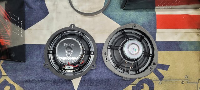

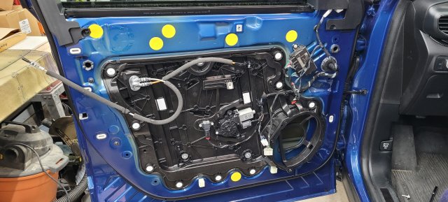

368
231
Replace the 6 factory speaker with Focal Inside. The speaker are a direct replacement.
Used Hushmat inside and around the speaker and door panel.
Really happy with the new speaker.
Front Speaker Focal Inside IS FORD 690
Rear Speaker Focal Inside IC FORD 165
