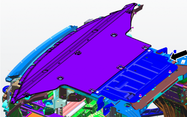

LOL same here! I posted in a different thread but when installing torque down the rear-most 2 bolts first on the tranny mount as they are threaded in aluminum and can strip easily. The other 6 bolts with the slip in Dzus fasteners required some effort due to the blue loctite put on the bolts.
