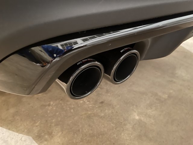

I had Borla S, Magnaflow and finally the 2.5 inch Thermal. The Borla S was nice but wanted a 2.5 inch system, the Magnaflow had awesome black chrome tips but droned around 2000 rpm and wasn't 304 stainless so lots of surface rust. The 2.5 inch Thermal sounds good with zero drone (OEM downpipes) and the 304 stainless finish but I did not like the Thermal black tips. I replaced the black tips with tips from hot rod scotts in Canada. Used a weld on tip and just cut the grooves similar to a bolt on set and then used SS 304 u clamps to hold the tips on. These ten inch long tips sit further back towards the bumper and could be extended further out if desired.
https://hotrodscottsonline.ca/collections/4in-exhaust-tips
