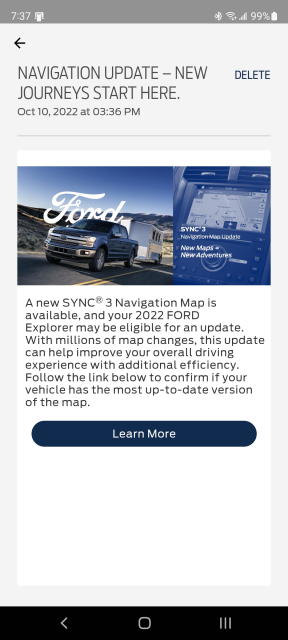

Mine still says I don’t qualify for an update or that it’s not available for my 2022.

Ford think my Explorer is a 2010 version.

Well Ford sent me a flashdrive loaded with the update and an email with instructions, but I already had the dealership push through the update from their end.
I suggest that all '22 owners open a case with Ford through the chat and they will send you a flashdrive with the maps update on it. Instructions Ford emailed me.
I have a tracking number for the USB that I requested be sent to you. Your tracking number is 278531889090. It is estimated to be delivered by end of business day today and is being delivered by FedEx.
Before Inserting the USB for the Navigation Update, I would like for you to do the following steps in order. I have included the instructions for each below the steps.
1. Master Reset
2. Key Cycle
3. Master Reset
4. Module Reset
5. Key Cycle
6. Master Reset
7. Insert USB
