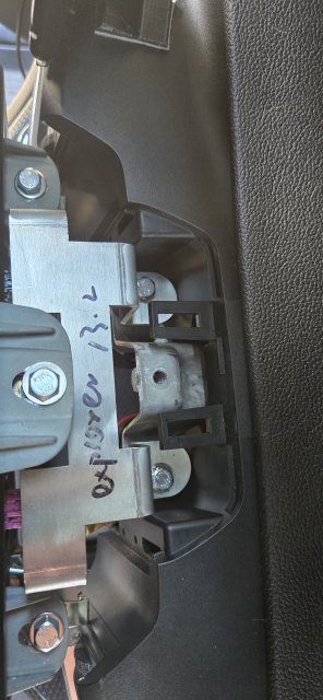

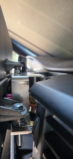

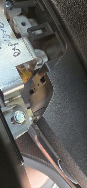

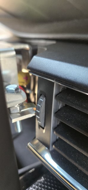

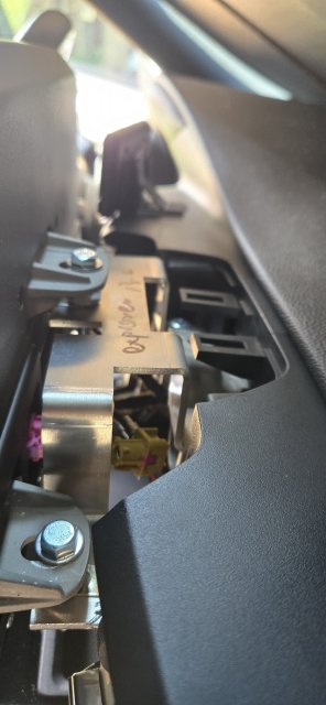

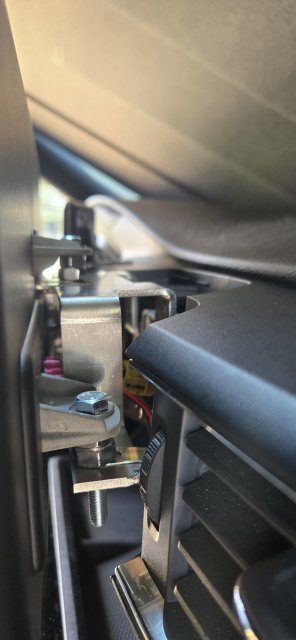

How does this mount up? Do you need to make your own bracket?
You will need to make a bracket.
I did lower the screen mount by .25" (Don't have picture of it)
See attached pictures.
