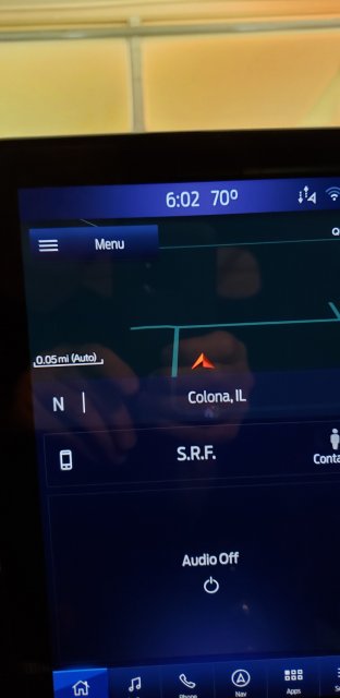

I did USB today. Still no temperature settings visible on the info bar but I have build 20136. The temps were nice but I guess I can live without them. 20201107_104500.jpg

I did USB today. Still no temperature settings visible on the info bar but I have build 20136. The temps were nice but I guess I can live without them. View attachment 2501
Interesting. Let me do some digging and I will yell back...

Didn’t even notice, but I don’t have it either. Went from 20136 to 20196 to 20237 in the past few months. Really didn’t notice it was gone. Interesting. Might have been intentional on Ford’s part since the regular HVAC controls show it.

Am in the process of updating to 20237 but did notice that my 20196 did indeed show the temperature setting up top. I did do a master reset after the past two updates. maybe try that?
Update: temp also shows in 20237. GPS location looks good.
BTW, master reset is no big deal. Re-Pair my iPhone, reconnect wifi, reconnect Ford Pass. Good to go.
