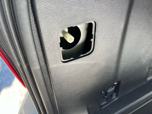

Quick question...trying to remove the interior plastic cover. What’s the best way? I am having trouble getting it out. Use a knife to grab the side?
28
Granite City, IL, USA
I just used a small flathead screwdriver from the bottom of the panel. Took some pressure but it will come off.

Thanks. Yeah I wasn’t sure what side to pry off first.
4,579
5,352
If you’re gonna do much interior disassembly some trim removal tools are cheap insurance against scarred up panels.

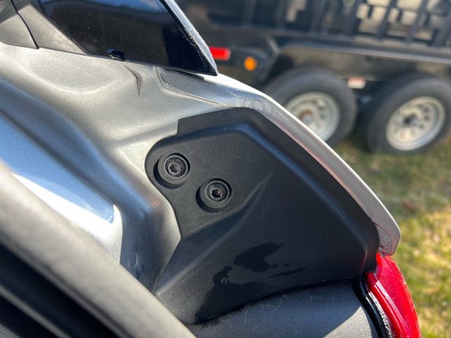

Can I get some help? First off I broke the cover off the access for the left side tail light. I also lost the piece that went on the outside of the of the tail light that gets screwed in. Don't ask. I added a pic of the right side as an example.
No need to remove the BIG Torx bolts from what I remember. Hardest part is the pin that is forward to the front of the truck on the lens assembly. I ended up using a towel and small screwdriver to pry out, with a lot of praying not to scratch the paint. After I watched some YouTube videos to see if there was an easier way and everyone just yanked them out so I am not sure what the best way is but scary when doing.
