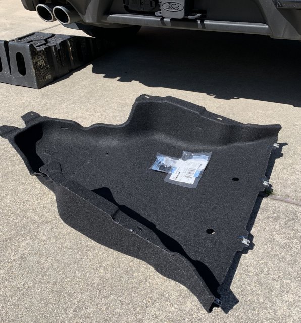

Will the rear wind deflector still fit between the Thermal R&D rear mufflers/resonators? Looks like it should.
