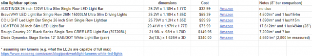

digging into more options... I figure, once this is mounted, you won't want to tear it apart to fix it (if it's a cheap part)
I'm reaching out to Diode Dynamics on a dual 12" light bar setup
IMHO setting up 2 x 12" bars would fill the space nicely (there's a 28" opening) - granted they're $340 and you still need a wiring harness, figure $400 for all parts
Diode Dynamics Stage Series 12in SAE/DOT White Light Bar (Pair), SAE/DOT Driving
(example below)

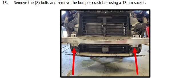

How are you going to mount it?
behind the grill, most likely on the crash bar support, will need to trim the radiator air deflector as it runs overtop the crash bar, but should be able to drill/attach there - just need the correct height mount to get it inside that pocket under the main grill

I would suggest using rivnuts in the crash bar. Do not just tap it.

Yep that’s my plan

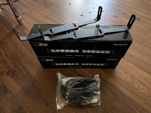

parts arrived, DD had a 15% off sale - just need to wait to get an intercooler then I'll crack the front off :)
DD said with these mounts instead of the regular ones should reduce the overall width from 30" to 26" which should fit perfectly!!
Parts ordered:
Diode Dynamics Stage Series 12in SAE/DOT White Light Bar (Pair), SAE/DOT Driving ~$400
Heavy Duty Dual Output Light Bar Wiring Harness ~$60
Stage Series 12 Inch U Bracket Pair ~$45
with the sale I got everything for ~$415, I was originally thinking a $100 light bar, but it's a $60k SUV, may as well go with a decent setup (but not obscene like Baja Designs)

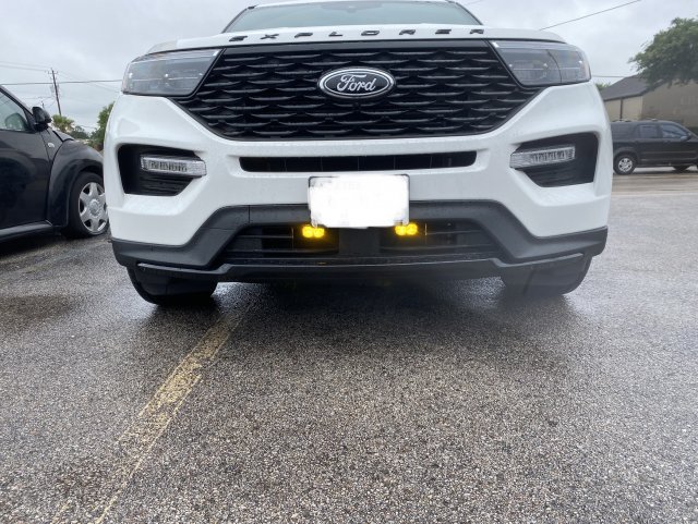

I added some amber leds on my explorer, they are hidden and mounted on the crash bar
Pics?
