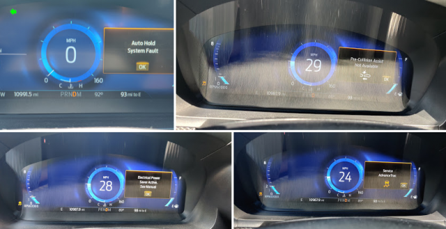

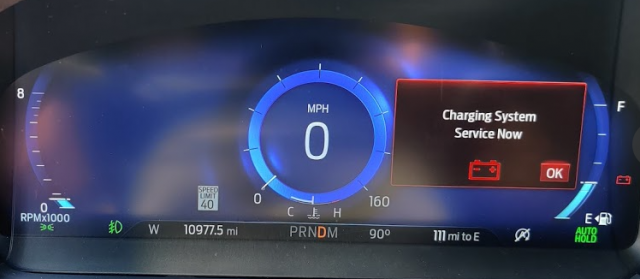

Maybe I spoke too soon. Mine had the same faults today: " Getting fault codes like traction control, StabiliTrak, cross-traffic amongst other codes." Dropped it off at the dealership after my 'power steering cut out'!!!! Ain't this some sh*t. I still like the vehicle, just sick of these electrical issues.

Take pictures when it happens. This helps document your case, as well as provide information for the service department.
It‘s now a safety issue and you might want to consider asking for a replacement vehicle.

Oh, I've learned from this forum to do that. But the problem is I already put a Borla S-Type after market exhaust. I'd be some $$$ in the hole. Plus, I'm a second owner. Will a Ford dealership take a vehicle they didn't sell to me back?!
I had many of these same faults. After some digging it turned out to be the module connectors. To the technicians credit he did not think it was the modules so he looked at all my connectors. The tech told me these connectors have pins in them the module I guess plugs into. On two connectors, the pins were crushed thereby not making a good connection and keeping the systems from talking to each other. Once all the bad connectors were replaced and the modules seated correctly, they reprogramed and it fixed all the problems. It has now been 3 months without a single fault.

Did your power-steering go out for a bit too? I sent your message to the Ford Service dept. Hopefully, they take some advice!

UPDATE: Part coming in for some component on the NEGATIVE side of the battery. They say this 'pin' melted and required a part from corporate to arrive. 2 days to get here. Will keep everyone updated.

UPDATE: Called twice to notify I'll be showing to pickup the Explorer on Sunday (since there is no $ due (service is closed), it is deemed okay by the dealership). Show up and no one knows where my car keys are located. Next day, they deliver my car to my home with a full tank of 93 octane. Repaired and seems to be working. I will take a long drive to make sure this week. Just glad the car is back in the garage.
