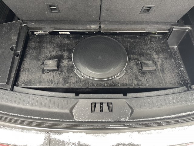

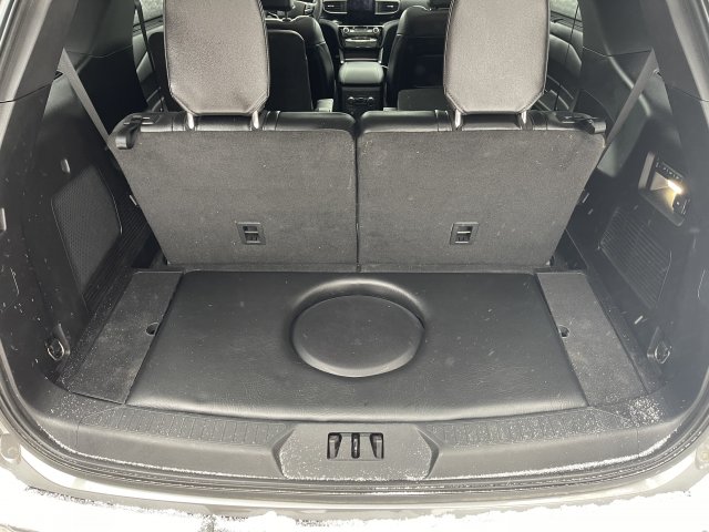

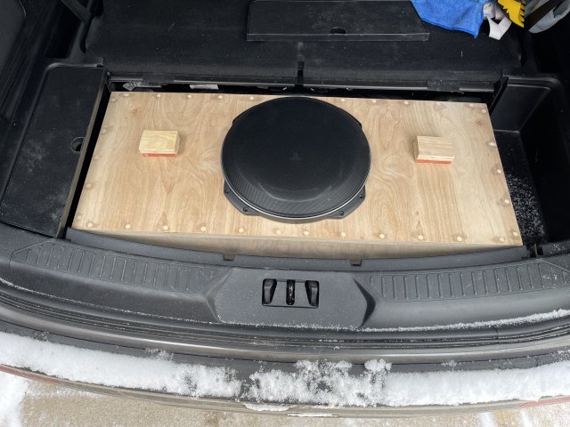

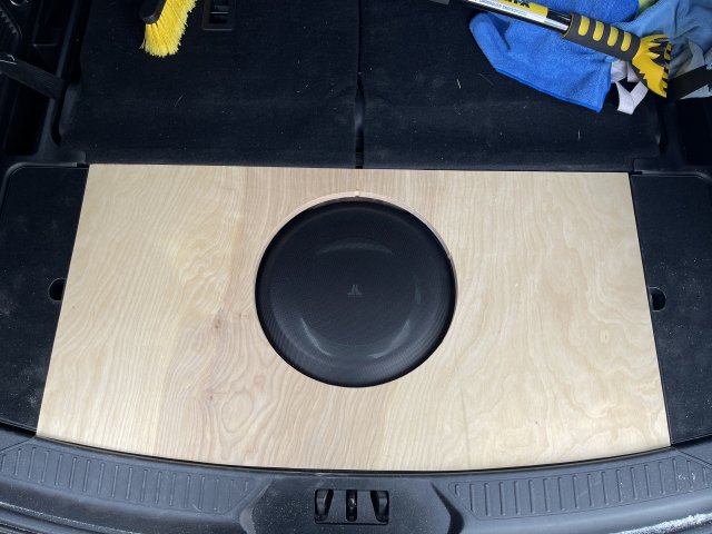

Sub install and cover complete. Need it to not be 6° and snowing so I can complete the LOC and amp install. C5FFF213-04E6-4000-B765-A0B3E01D5906.jpeg 5727ABAA-62B1-4040-83B6-7C406B5056A2.jpeg 3FEFD9C9-8DCE-4A7C-8FEE-63EC89880CF7.jpeg 503A8C86-325F-4BB9-8F83-F4087E5AF246.jpeg

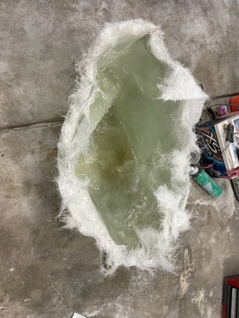

I just finished the first layer of fiberglass for my sub enclosure. I wanted to get one good layer hardened so I could pull it out and do the rest of the layers on a table. Epic fail. Well almost epic. Had a couple large pieces fall from the top and hardened in a mess. Pulled it out with a big hole in the top. Was able to cut and grind enough so i could salvage it and put a couple pieces on last night so it is one complete structure albeit very thin. Hoping to grind some more later today to get it into shape for a few more layers. Then fill it with water to see how much space i have. I think it is too big and I may need to cut down the interior volume a bit.
Turns out I fiberglass like I weld.......lay it on thick and messy and grind it down :eek: I'll post a pic later.

You’re gonna want at least 5 full layers of chop mat for a glass enclosure and you’ll need to deaden it after that. Fiberglass enclosures will audibly ring.
After you get all the layers in place go buy some lead shot and mix it with resin and coat the inside of the enclosure…you can add a lot of mass fast that way.
Thanks for that tidbit. I was going to go more layers rather than less especially with a somewhat lousy first layer in some spots. I've got a good solid layer now where the structure holds and I will add at least 5 more. Happen to have some lead shot laying around too.

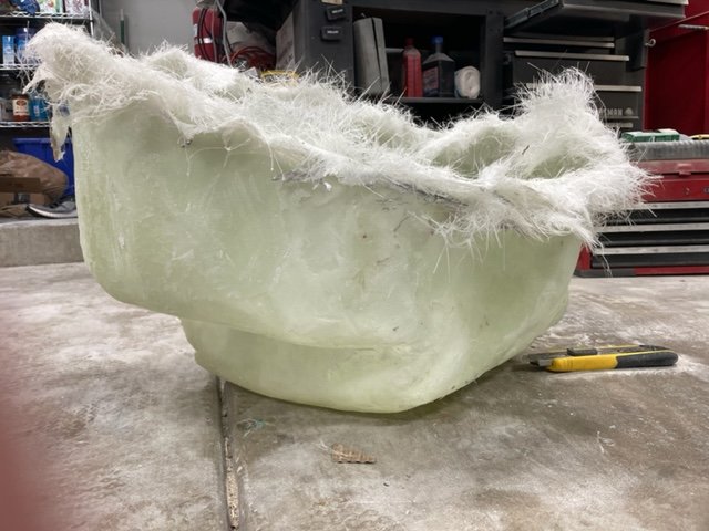

So in case anybody is interested, you can fit a TW5V2 sub in the oem sub location with a custom box. Got 4 layers on the back and sides of the box and I did a quick test fit and filled it with water to see where I am at. I've got about 6" of space from the top of my box when layed on its side and filled with water. I may end up spacing the sub out about 4" instead of filling space as once I add the speaker ring I will probably add .2-.4cuft because I'd rather keep it as close to .8cuft as I can. Now to get another couple layers on and fit the ring and finish the box and get some sound deadener in there..

Here's a couple. Waiting for some more epoxy. Putting a couple more coats on the box and then I need to build the speaker ring and front with some fleece and more glass. Planning on cutting down about 4-6 inches off the top once I get a better idea of total volume. If you notice there is a step in the bottom. That area goes into the space rear bottom of quarter panel. There is tons of space there and I'm guessing I'm only using half to 3/4 of the space available there.
