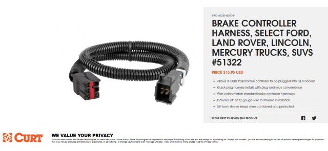

You need to install a brake contriller such as this one. https://www.towuniverse.com/2002-20...MXjZLN-7hddsVyp9kA19FtFVfzF_ri-hoCNucQAvD_BwE
With out it you have no trailer braking. It's easy to install as there is a plug by the steering column on the Explorer this plugs into. If you are not familiar with this you may want to have a shop install it for you.
