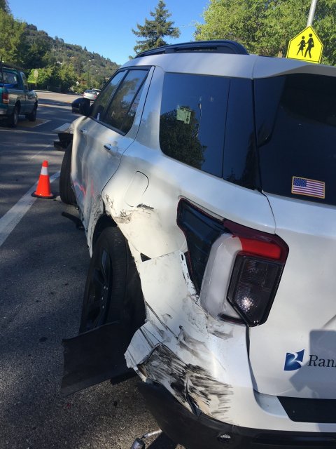

Its only a bummer if they don't total it. I haven't actually seen the car yet, just these photos but the CHP officer told me the rear tire is pushed 6" forward and sticking out a few inches. I'll have to see what that looks like in person. I will be going to the tow yard on Monday to clean the car out and get more in depth photos.

Thanks! My ST had actually quit running the morning this happened. I was about a mile from home heading to the freeway when it died. Called my wife to come get me and then took her car to work. This happened about an hour after I had left it. According to the CHP this may be a distracted driving case.
Save your jealousy until I find out if it is totaled or not. If they don't total it I will be jealous of all of you! Lol
I would blast Fords social media accounts with this, what if someone would have been in the car..... Its not like this is a new issue they seem to be pussy footing around instead of fixing the problem for those unlucky to get hit by them.
