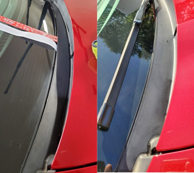

Huh... I wonder if this is the water leak the first ST I looked at was having. I was told it was behind the dash, but maybe they were mistaken. Would have saved me a lot of headaches if I had known... Ah well. Guess I'll check mine.
Dgoebel57
136
89
Faribault, MN, USA
I discovered that a water leak behind the dash can be caused by the windshield bottom trim being loose and not sealed to the bottom edge of the windshield, especially if a Battery replacement was needed. Windshield leak before and after trim corrected.jpg
