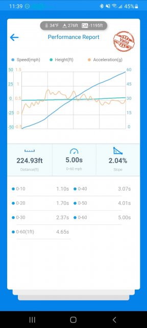

first every dragy. I got the device Friday so the weather hasn't been that great. I was more trying to figure the dragy app than try a good run. I had the device just siting in my lap, not so good for a test. I forgot to put it in Sport mode as well. Once I get some better weather I'll try a couple of 'real' runs at a longer 'test area' to get full stats. :)
