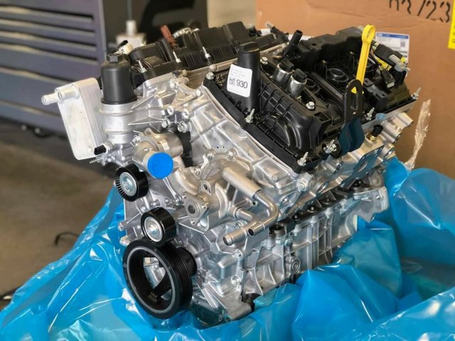

In most sources I've seen though, the 3.0 was switched to a cast aluminum block. Has anyone confirmed what the actual material is?
Sent from my SM-G975U using Tapatalk
ZFGracing
325
589
117
Marinette, WI, USA
Thread Starter #39
That's incorrect it is still a compacted graphite iron upper.
It comes down to advertising Ford advertises the truck motors as having the iron block because that matters to people cuz they want the perception to be that it is a strong motor and really only half of the block the upper half is cast iron or compacted graphite iron.
On the cars and all of the Lincoln stuff they advertise it as an aluminum blocked because they want to give the perception of it being lightweight and Powerful.
In all reality the motors are nearly identical with only a slight difference in bore and stroke and camshafts. There's also a couple different head configurations depending on if it's transversely mounted or longitudinally mounted.
ZFGracing
325
589
117
Marinette, WI, USA
Thread Starter #40
Here is the st motor, the CGI upper block is visible. This is true on all Nano applications, all Nanos have the cgi upper block. FB_IMG_1592828883268.jpg
