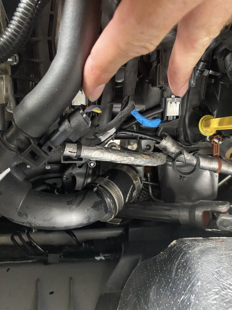

Misfire on cylinder 4 after the plug swap.
So I followed normal protocol...swap coils 4 and 5...misfire stayed with 4. Pulled plug...insulator is good, plug is wet...definitely not firing.
Now get THIS shit. The sensor plugged into the hose for the PCV is the EXACT SAME PLUG and they’re right next to each other. I had them all undone to make room to work and got them flipped. Learn from my mistake if you’re swapping plugs.

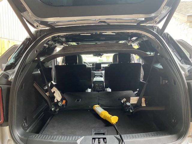

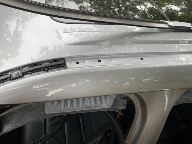

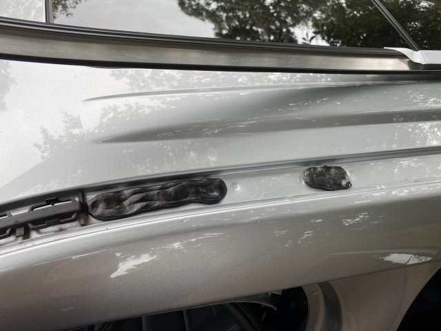

Slick top ST. 4 hours start to finish and not for the faint of heart. There’s 3 holes left on each side...I used butyl rope to smash in and seal them. And I guess this puts to bed that they will definitely work with a sunroof.

Looks great! I really want to do this but wow when I saw your headliner hanging down it scared the crap out of me. Especially since my dealer just replaced my entire headliner. Nonetheless it’s a great improvement in my eyes! Jim
