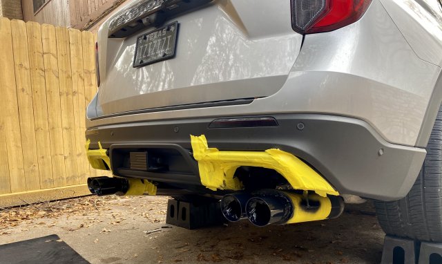

Exhaust is finally complete. Cleaned up the weld discoloration and buffed everything and touched up the paint on the tips.

I swear I’m a glutton for punishment and for some unknown reason I actually like messing with exhaust systems...I love experimenting. Now that I have everything exactly how it should be and sounding great...I ordered a pair of Vibrant 1136 mufflers to try out back. I just gotta know what they sound like. lol
I already have more black tips and mandrel bends so I’ll just cut the Magnaflows off at the weld and fab these in from there. If they suck I can reverse it with 1 cut and weld.

I'm curious to hear how this sounds when you get it done. Someone else on here did Vibrants as well and they sound pretty good.
And I am with you about the exhaust.....seriously no pun intended...but its a major component in setting the tone for the car!

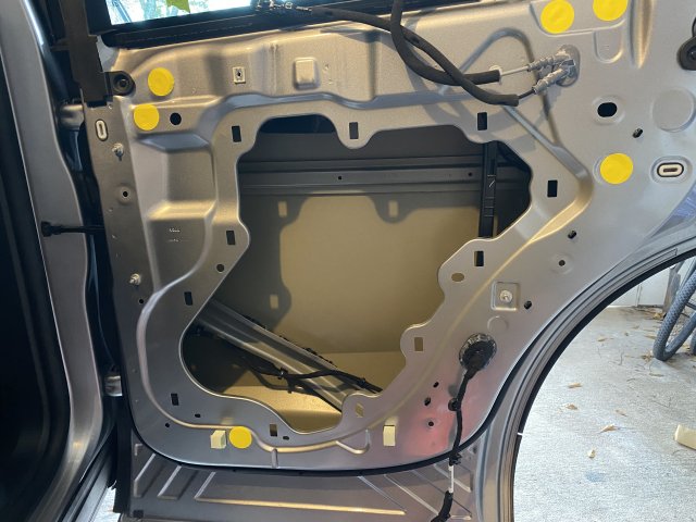

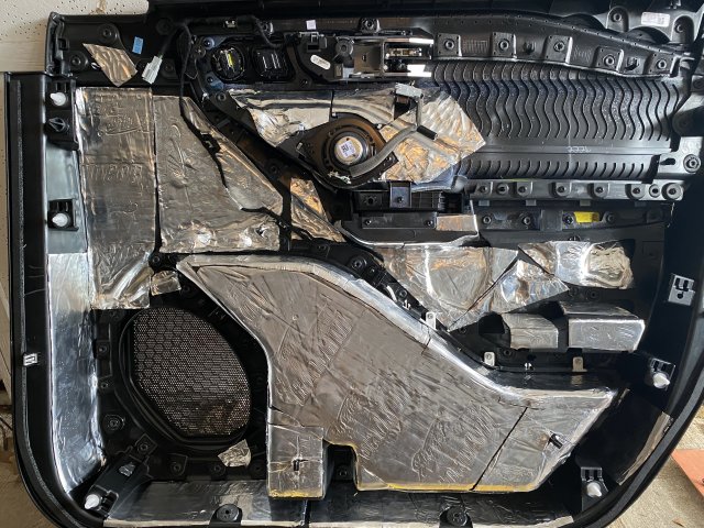

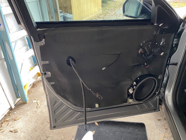

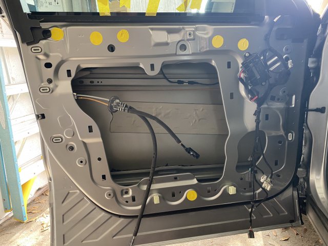

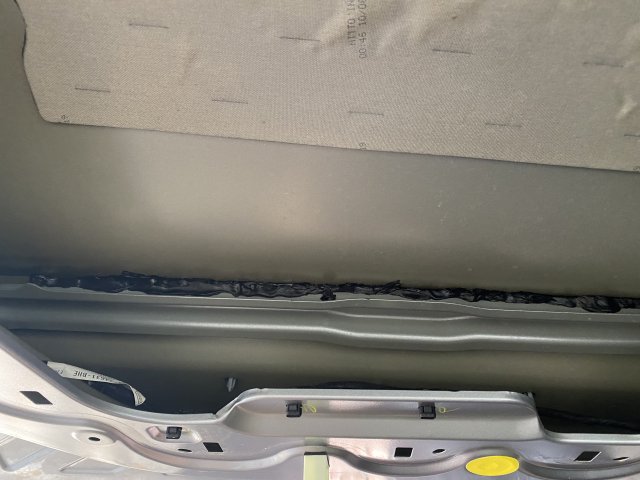

More deadener for the next couple of days. Tessa tape on everything that’s not wrapped already, butyl rope in the voids between the crash bars, CLD and CCF.

Thread Starter #396
And the results after the first door.

Pretty impressive. Sounds like you're knocking on a solid wood block.

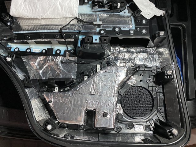

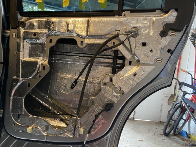

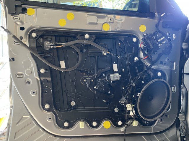

Rear doors are done. I’m taking a break from deadener...I’m wore out. lol
