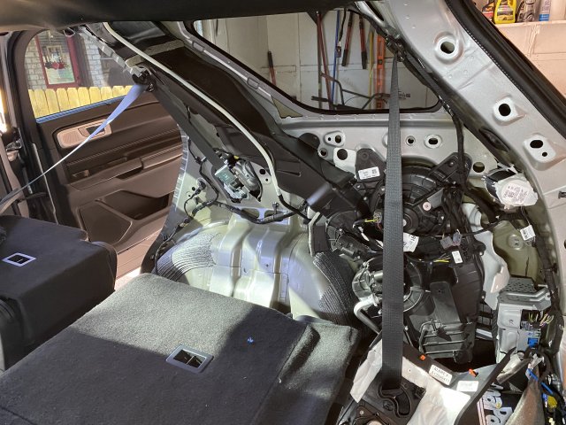

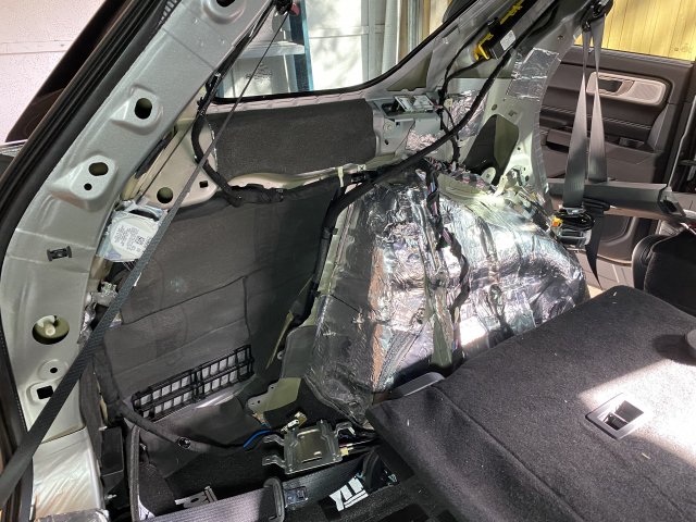

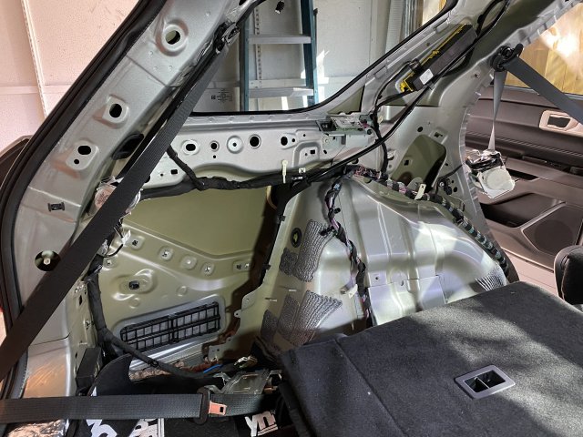

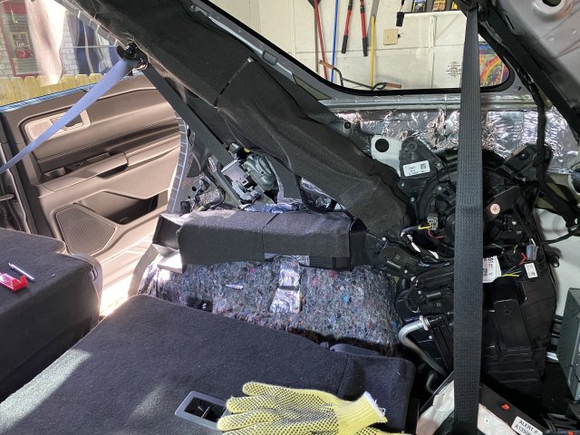

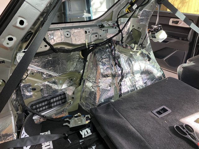

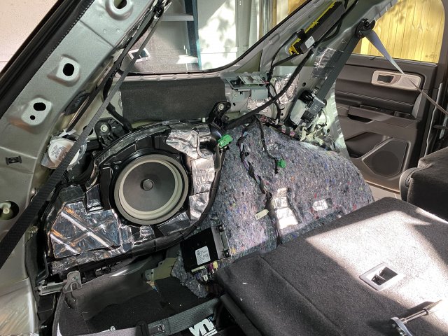

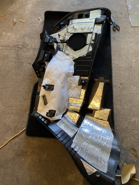

More sound deadening. I didn’t even try for 100% CLD coverage here...there’s way more than enough. There’s a LOT of crap behind these panels too. I spent more time removing stuff than putting in CLD and CCF.
I added CLD and CCF to the rear ac ducting...they definitely needed some mass added and I figured the CCF may even make it blow colder.
I have a ton of CLD so I figured I’d slap some on the sub enclosure...that thing sounds like a tin can when you tap on it. Should be a little better bass response now. Anyway...all that’s left is the floor and that will happen when it’s gutted for the actual audio install. I don’t feel like pulling the seats twice.

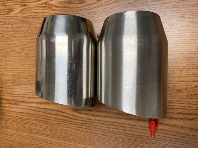

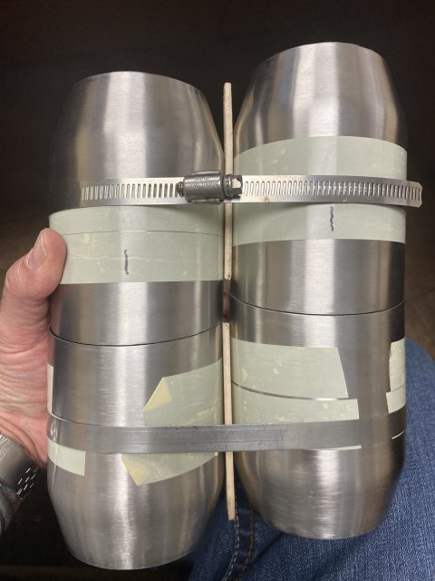

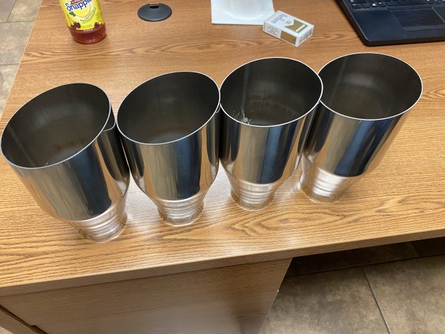

Haven’t done much lately but I had this on the back burner and finally got to it today. I’ve been through 4 sets of exhaust tips on this thing...I was trying like hell to like the black tips but I just couldn’t do it. Didn’t want polished or chrome either and I decided I hate the double wall tips...and rolled edge tips. I tried both styles. I settled on 4” single wall brushed stainless but the only ones I could find with a 3” inlet were $70 each so I had to get creative. I found some 2.5” inlet polished tips for $14 each...cut them for a 3” inlet then spun them on a belt sander and got exactly what I wanted. I hate crooked tips so I fit them up with a spacer and welded both sets on together. 7859A97B-5FFB-421F-8FCA-49E57B01862E.jpeg CA02B909-B686-4A30-BD9C-1DA710E58435.jpeg 627A018A-E11E-4CCF-9A49-34019669688D.jpeg A3D03AC8-44C6-459C-8ABD-BAE5E0AF757C.jpeg

Based on that pic, I think your left-most tip might be crooked. ;)
Nope...both are dead even. Pic looks off but they’re not.

Yep.....definitely crooked. Better redo them.;)
I mean, its bad enough he should probably just start from scratch and redo the entire exhaust system at this point.
