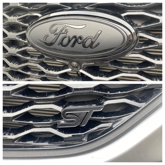

Main emblems are from OEM Auto Art...I had a matte black inlay in the ST emblem but it still had the chrome surround. Popped it off, pulled the red inlay out, sanded and sprayed the chrome in gloss black then put another matte black inlay in to match.
Yes, I get bored easily. View attachment 4369
How easy does the red inlay pop out?
It’s just a thick sticker basically. I used the edge of an exacto knife to slide under it and pop it out then some acetone to clean off the glue.
May jump on that when I get home....looks really clean on yours
