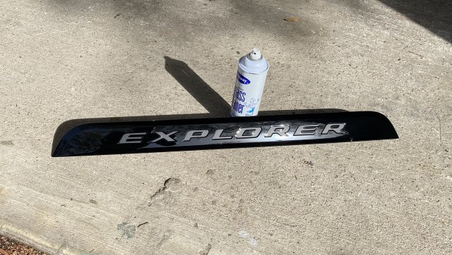

8C0BA670-1F3E-476C-AF37-4B7D507F844C.jpeg 340A9F44-7BD0-461F-B682-952C645D7247.jpeg Shaved the liftgate panel...I think that Ford oval is next on the chopping block.

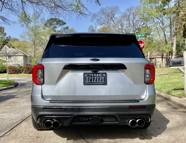

That cover cleans up with a water hose...it’s been raining a lot lately. I washed it this afternoon and it’s good as new...and I actually like that it hides the diff. It’s functional too....really firms up the rear bumper cover with it’s installed.
Fresh wash job pics...the back view will change next week when my shaved trim panel gets outta paint. View attachment 4773 View attachment 4774
Explorer on the back painted or inlays?
