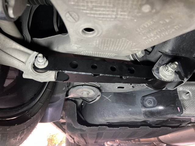

curious to know what these do. Are they worth it ? Will they improve the ride / handling?
They will help keep the suspension geometry in shape on a hard launch for sure. The bushing in the oem link is soft as hell and I think that’s where some of my wheel hop is coming from.

Upgraded toe links and vertical links were key to helping my buddy's S550 GT tame the wheel hop. Maybe Steeda will get cracking on those as well.

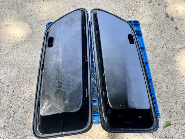

I think everyone knows these things get crazy hot under the hood. I don’t like it so I wanna vent some of that heat out. After a lot of searching I settled on vents from a newer Jeep. It looks like they’ll fit the hood well in both shape and size. Placement will be something like the first pic.

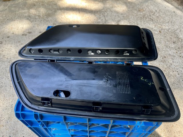

I started modding the vents today. Sanded the mopar logo off and drilled 1/2” holes around the sides. The thought is to still let heat out but retain the water drain which will drop out right on top of the strut tower and not on anything important. It’ll be at least a few weeks before I find the time to finish them up.

Now that is a mod that I can definitely appreciate. Also notice folks in the back how he's considered where the inevitable water will end up. Also notice how the current placement is far enough away from the windshield to avoid the high pressure area at the base. All things to be considered for a well-designed mod.

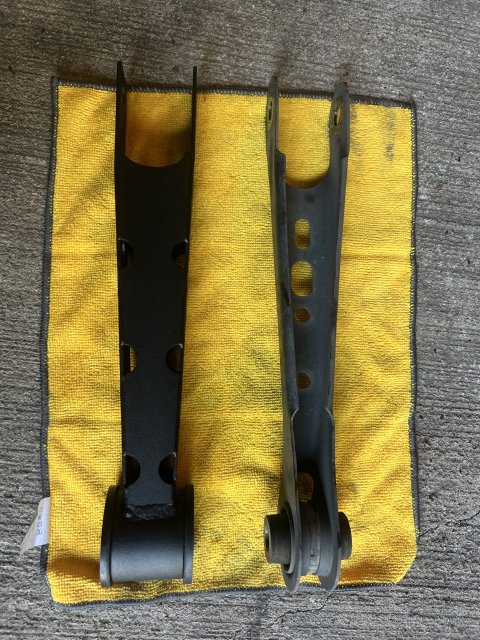

Got the FenFab toe links in today along with a still “secret” rear diff brace I’m testing. No pics of that but here’s the toe links. The oem bushing is soft as hot butter…I hope the firmer bushing there will help eliminate the wheel hop I get on really hard launches.

Keep us in the loop on this“secret” rear diff brace! Also I'd love to hear how the firmer bushings workout with the wheel hop issue. (y)

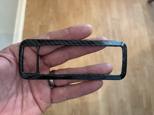

Also finally wrapped this little trim piece since the Chinese guys haven’t made any silver ones. 8B998344-89FF-484D-ABA4-220A9B16FE15.jpeg 838EAF8F-E4AB-4203-B619-08CD940DD077.jpeg

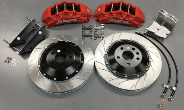

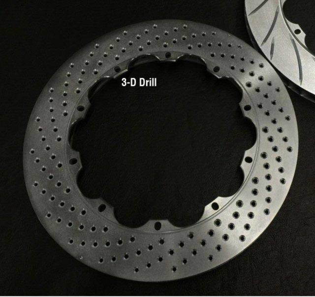

Screw it…I like giant brakes. lol
I’m doing the drilled rotors…not the slotted ones. 3C7DDD39-874A-4BDA-B39B-24607316B7D9.jpeg 9D075C8D-6AB6-4E5D-B4A1-E74653791025.jpeg 949E8576-6E9D-4832-B666-3C1C4DCA2F38.jpeg
