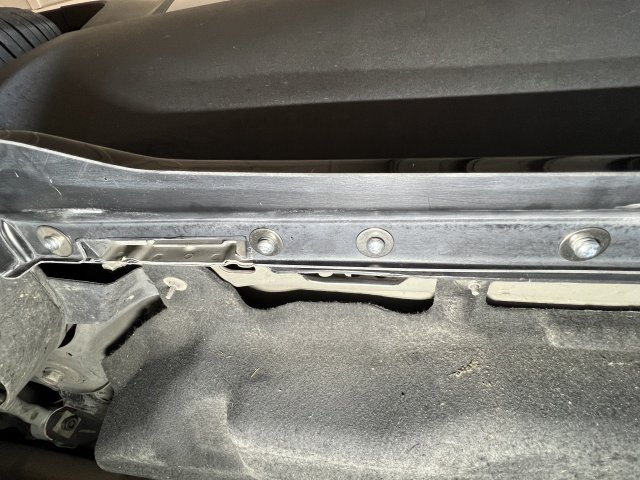

Waido side skirts are on but the lighting is atrocious right now…I’ll get better pics tomorrow. For install I had to rethink my plan because the skirts aren’t shaped like I thought they would be.
I marked out and pre-drilled 1/4” holes in the skirts then added 3M VHB tape and stuck them in place. Next I pre-drilled 1/8” holes through the plastic the runs along the bottom then ran in #14 x 5/8” sheet metal screws with split lock washers and 1” fender washers to spread the load out. Seems pretty solid. They look great…my pics all sucked. lol
Next week I’ll add some 1/4” pinch weld moulding along the bottom so in case I drag them on something there’s a buffer in there. IMG_1963.jpeg IMG_1960.jpeg IMG_1950.jpeg IMG_1951.jpeg IMG_1949.jpeg IMG_1952.jpeg

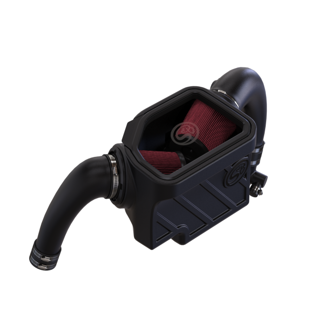

Things ordered and on the way:
PIU struts and shocks…I crossed 80k miles so it’s just time.
S&B CAI to replace the AFE…nothing wrong with the old one I just like the S&B better. I don’t really like the red filters so I’m gonna wash those clean and use blue oil instead.
