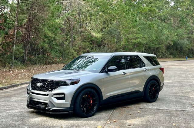

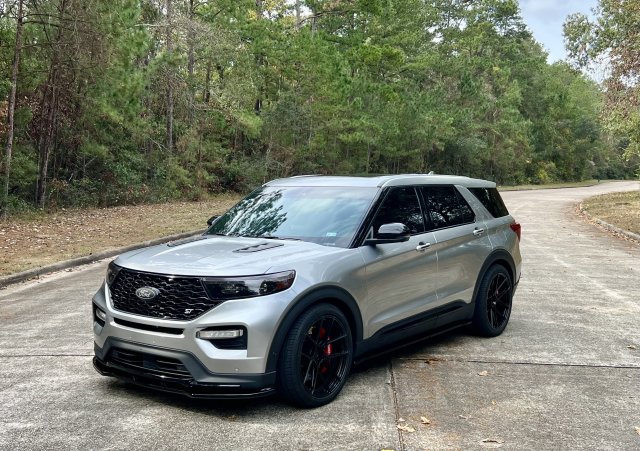

This is the 2nd longest love affair I’ve ever had with a car…with no end in sight. IMG_2134.jpeg IMG_2145.jpeg IMG_2149.jpeg

Iconic is certainly the best way to describe the build brotha! Did you do a roof rack delete? Or just left it off from factory?
All 2020’s came with them so I had to delete them myself. I wish it had been an option back then.
