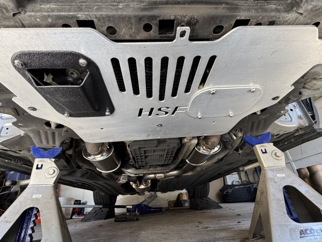

Here’s how I did the Ultra Quiet’s on the 3” Thermal. I shortened the SPD DP’s and got rid of the support bracket, fit and clamped everything then pulled it apart and welded one side so there’s only one clamped connection there. Overall it’s absolutely quieter than any Thermal I’ve heard. Once it’s back on the road I’ll get over to HSF and get a comparison video. View attachment 28053 View attachment IMG_5903.jpeg

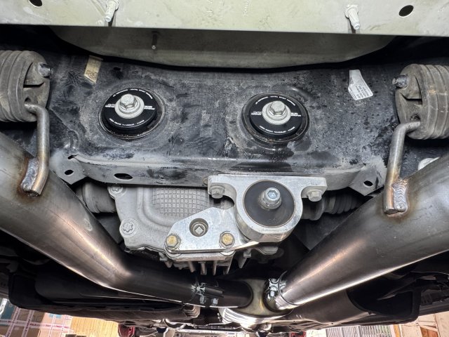

Todays stuff.
Houston Speed Freaks skid plate, JXB bushing inserts (I have the HSF bolts but need to grab a bigger Allen key) and got the tinted Euro heads in. Notice in the one pic they have adjusters for both high and low beams instead of only one for the US version. IMG_5906.jpeg IMG_5907.jpeg

1,833
1,323
Digging those headlights. Also threw some Vibrant resonators after down pipes for a little quiet. They were slip fit so I kept it that way for now. Drivers side went 4” behind the DP and the passenger side went after the flex joints before the Thermal mid. Was also very happy with new sound.

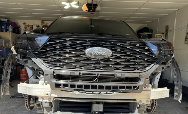

Thread Starter #1,299
Sneak peek with the heads, ST-Line grille and tinted Timberline emblem. IMG_5911.jpeg
