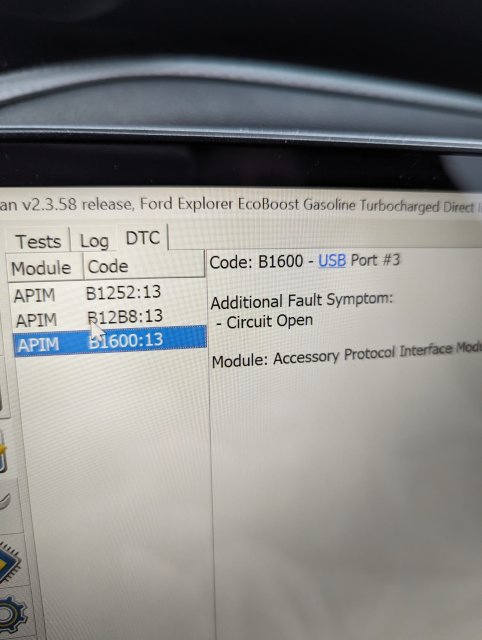

Codes B1252:13
B12B8:13
B1600:13
Good that you found error codes, better than a mystery, did the codes clear after the reset? Use this format to google the error codes b1252-13.

Codes are here to stay. Cleared them out, re-scanned, and they are back

Can only find one of the codes online B1252:13
Have you tried an on demand APIM self test using FORSCAN?
Try self test with and without plugged in known good USB devices.
APIM Master reset, I think you lose all your settings and paired devices.

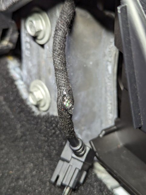

Found the problem. There is a deep cut into the cable near connection in the side panel of the console. I grabbed it and squeezed where the wire is cut, plugged my phone in, and it began connecting to Android Auto
Congratulations! I bet if you had taken it in they would have charged you to replace your APIM, plus a diagnostic fee or two.
