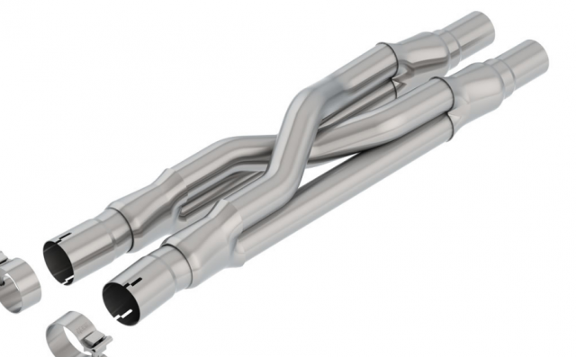

Can someone try this Switchfire X pipe, and let us know.
1,500
#60
Let's see: this design decreases the exhaust velocity by at least half. Increases in volume decrease velocity and increase pressure. It probably triples the surface area which lowers the heat retention...also decreasing the velocity. So it's a no-go from a performance perspective.
But, it looks cool- guess you could get your buddies to crawl under the truck for a look.
