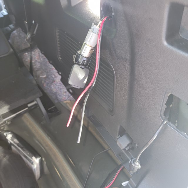

Those look nice. I ended up installing and placed the vacuum pump under the spare tire and ran out the vacuum hose through the pressure relief panel and left the power cord snaked to the right rear power outlet. Sorry not very clean... View attachment 12120 View attachment 12120

do you have pictures of the pressure relief panel? I cannot figure out how or where to get the hose from the valve piston into the car.

it is in the trunk area on the right side with the outlet you need to pull the panel off

You don't need to remove the side cover. There are some vents at the bottom of that side panel. Get the hose out from the inside to the side. It's easier than trying to get in from the outside.

Thank you!!!! So helpful.

All installed and love it. Couldn’t have done it without your help. Thanks!!
