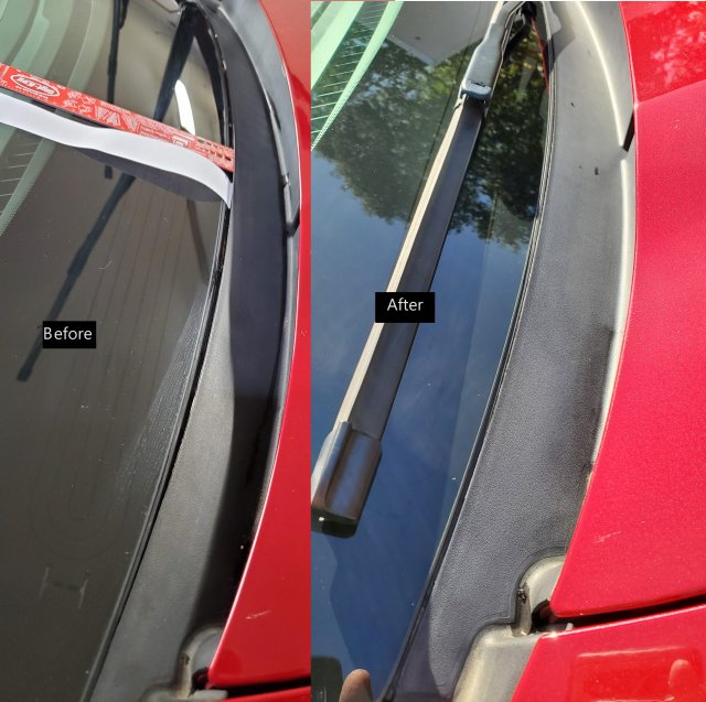

Just discovered that my '20 ST has a 1/4 separation from the bottom edge of the windshield to the sealing gasket. I can see debris inside the gap, so I'm gonna try and clean it out and either seal it myself or take it to an automotive glass shop.

Turns out my passenger side cowl wasn't warped at all, just not fully seated. I opened the hood and just pushed back on the cowl piece and it snapped under the windshield. Tested with a 1/2 gallon of water, no leaks. Photos of before and after
