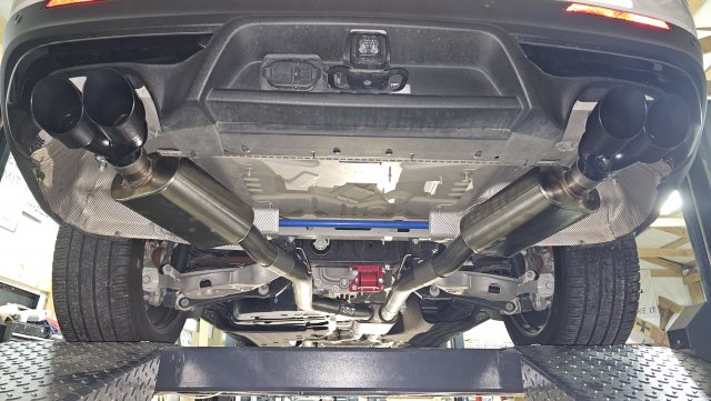

Put the ST on the rack in the garage at 10:41pm, finished the removal and install of the Thermal 3" at 11:47pm. Fixed the misaligned tips the following morning. Hands down the best exhaust for this thing. Fitment was flawless, except I wish the muffler hangers were a tad shorter to bring the tips closer to the rear valence.

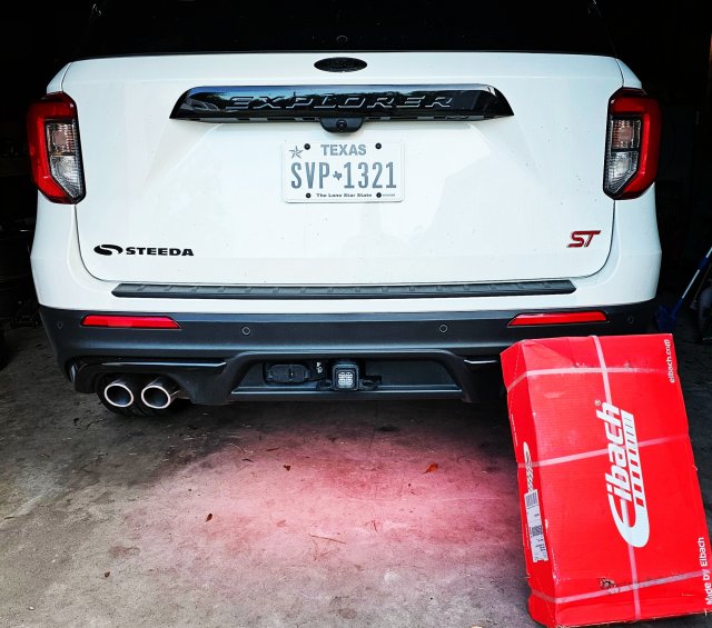

@BooSTedExplorer21 is that the Eibach spring kit? If so have you installed them yet? Very curious about them, we are an Eibach dealer at work so I have been thinking about ordering a set.
I haven't yet but itsxa good medium between steeda and h&r. I've heard nothing but good things about them
