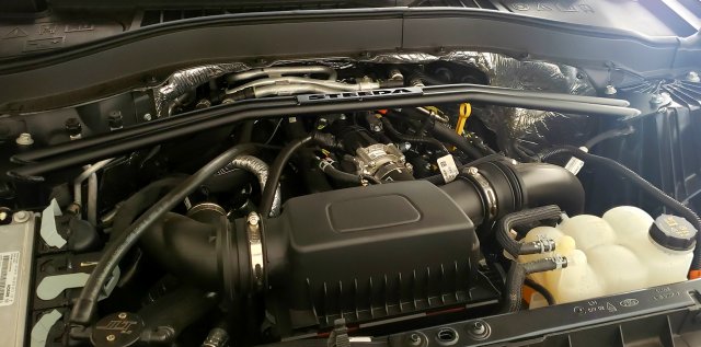

Installed the Steeda strut tower brace. No more fat, flimsy, stamped factory trash. Hopefully do the rear sway bar next week.

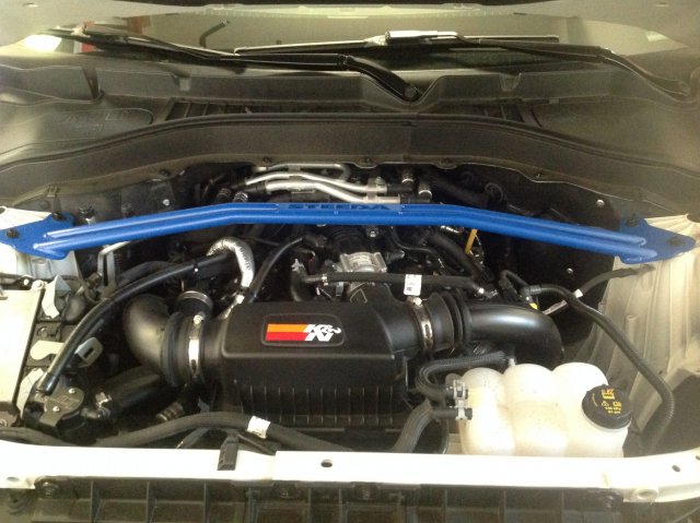

Nice! Did you have it sand blaster or leave the rough texture?
Was going to have it media blasted but after talking with the powder coating people I decided to leave as is. The blue pc filled in some of the texture. Real happy with the result. Completed the Steeda package, springs, rear sway bar and now this.

Cool, sounds like the exact same thing I am doing except I am painting mine red to match my calipers. The blue does look great though.

Can't go wrong with red. I went with the black cap bolts M8x1.25x25 and 45 for mounting. Gives it a nice finish. I know it most likely has little effect but you swear you can feel a difference once installed.

I noticed that. I was going to ask you where you got them. What is the 45? I really think it will make a difference. No reason to produce them if not. Can’t wait to install mine.

45 is the length but you can probably get by with shorter. The bar comes with a spacer and longer bolts, one for each end. Careful when installing. My sausage fingers let one slip. Almost lost it in the bowels of the engine. You'll need to find a specialty bolt place. In my case it was Charlotte Bolt. I don't know what the finish is called but it looks anodized. No clue of the grade but I'm sure it's enough for this use. Guy told me they would not rust. Hope that helps.

Cool! Thanks for the good info.

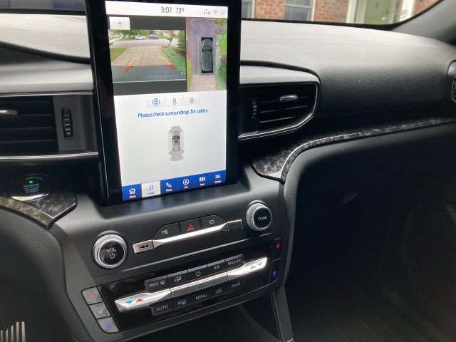

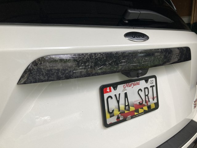

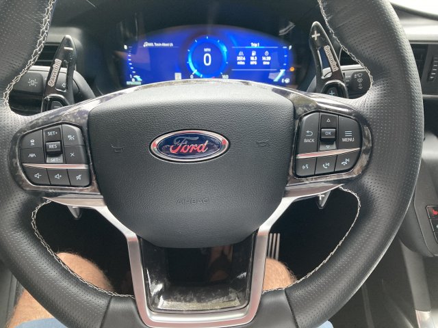

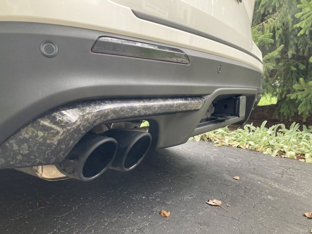

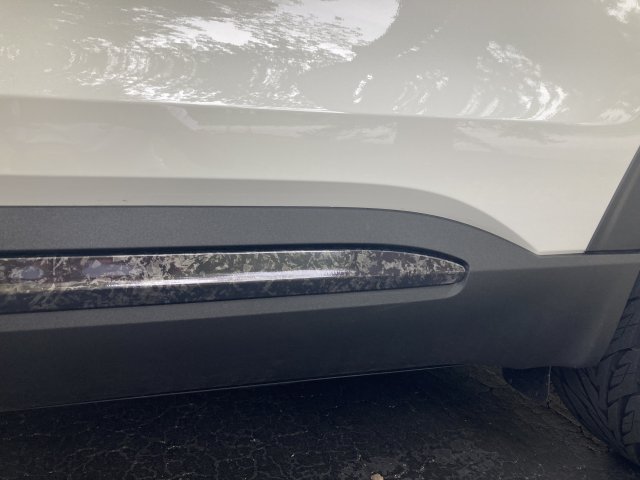

The random 3D weave carbon fiber on the dash bothered me and I had leftover forged carbon wrap from doing my hood, so I figured I would make the interior match..... and then I just kept going...
