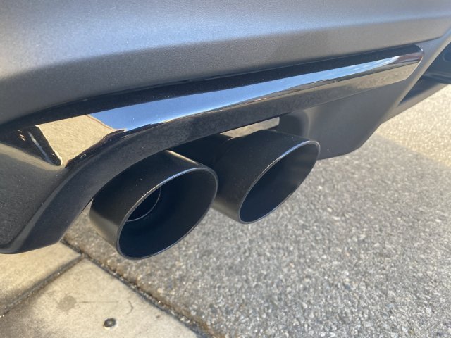

Shit canned the Thermal R&D exhaust tips and went with something that looks similar to the Borla S Type exhaust but in Carbon Fiber from Hot Rod Scott's in the Toronto Canada area. They had the weld on end so ground a gap on each side so they could be clamped on. (they could custom make what you want) Used a U clamp versus the Borla type single bolt clamp as the Borla type clamp wanted to slide off the tip towards the muffler when attempting to center in bumper exhaust tip hole and tighten the Borla type clamp. U clamp solved that issue. These slide over the exhaust pipe extensions on the outlet of the Thermal mufflers and bottom out in about the right place so they are fully engaged on the muffler stub. These are ten inches long max and are twin 4 inch outlets including the roller carbon fiber covers. The rest of the tips are a flat black. They have none rolled tips also.

Are you guys making the exhaust tips even, or leaving them offset like the stock ones are?
953
639
Offsets vary by manufacturer. On the Hot Rod Scott's Rolled Carbon Fiber 4 inch Quad Tips the inside pipe sticks out about 5/8" more than the outside pipe. On the Thermal R&D tips the inside pipe stuck out about 1" more than the outside pipe plus the Thermal tips, as a unit, were 11" long versus 10" long so both Thermal R&D tips then stuck out an additional inch versus the Hot Rod Scott's Rolled Carbon Fiber 4 inch Quad Tips.

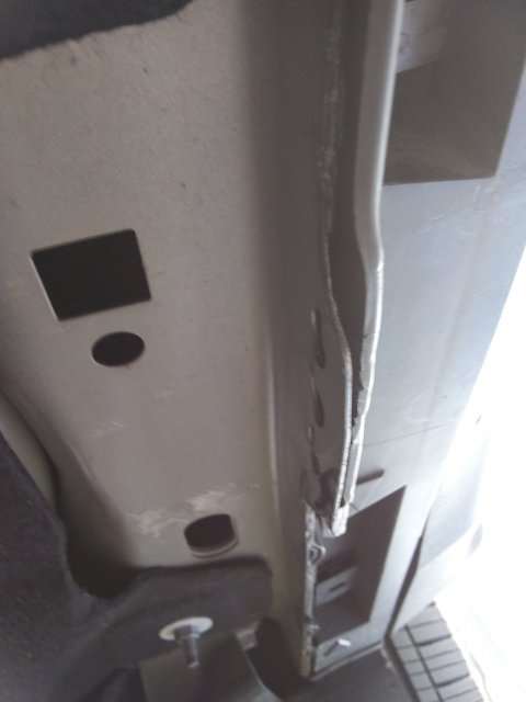

Fixed this dealer installed screw up (Bob Wondries Ford):
Still needs a slight adjustment...

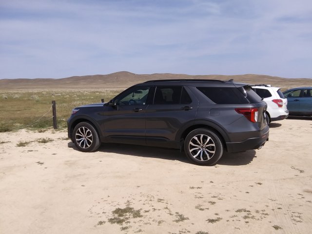

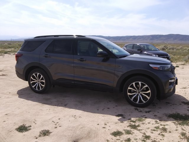

Took it off road a bit, then washed & detailed it.
