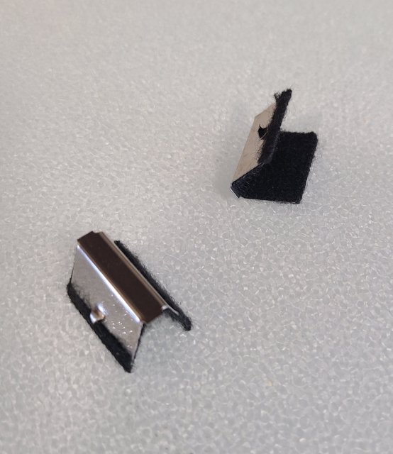

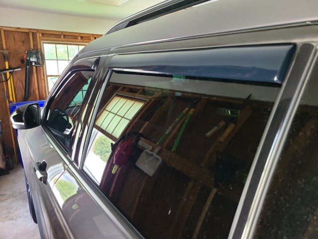

Added in-channel vent visors purchased from SuperAutoUSA.
Installation Notes:
  • In order for the windows to roll up with no issues, rear flanges from the first row visors and front flanges from the second row visors have to be wedged between the gloss black B Pillar trim and the rubber trim. All other flanges slide into the window channel.
  • Tesa tape was added to the metal retaining clips in order to prevent potential window scratching/window tint marring.
  • When installing the retaining clips, the barb side contacts the rubber trim and the smooth side contacts the visor.
Driving Notes:
  • No significant increase in wind noise when driving city speeds.
  • At highway speeds, there is a slight increase in wind noise. With music playing though, the increased wind noise isn't noticeable.

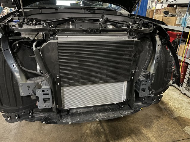

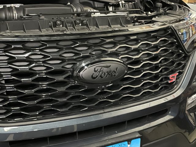

Installed the Whipple and put the blacked out front badge on.
I could've had the patience to install the badge. Maybe.
FMIC? NOPE!

They are not that hard, I did mine a few weeks ago. The hardest part is getting those two bolts out that attaches the bumper cover to the fender on each side.

Sorry, you lost me at they're not "that" hard. Lol

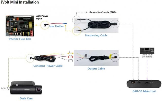

Installed a battery pack for extended Park Mode and isolation from the car's battery, for my THINKWARE Q800PRO dash cam. Easy peasy if you already have the hardwire cable installed to your fusebox--you just need ACC (spare fuse 37) and ground. I have the unit sitting underneath the driver's seat.
https://www.amazon.com/THINKWARE-iVolt-Mini-External-Battery/dp/B07YGVQ1V3?ref_=ast_sto_dp
Edit: price seems to fluctuate. I paid $209.

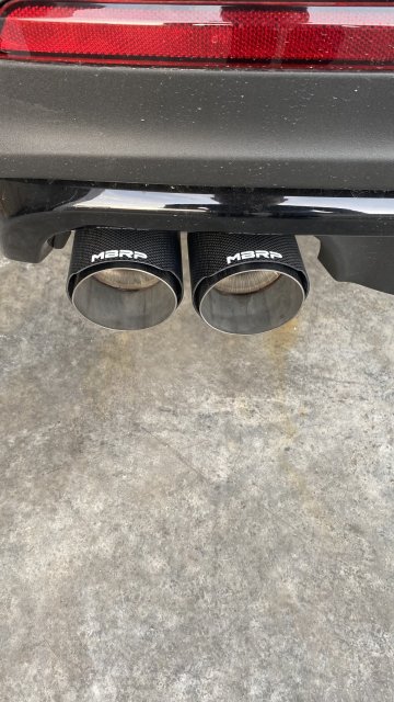

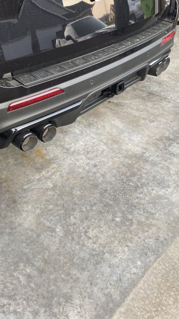

Got the exhaust yesterday and couldn't wait for the weekend! Easy install and definitely adds A LOT of character to the ST!!

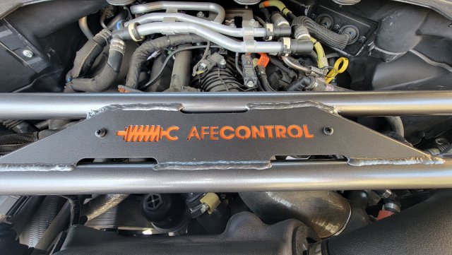

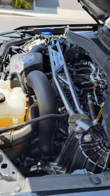

Had the new strut tower brace from aFe installed!
