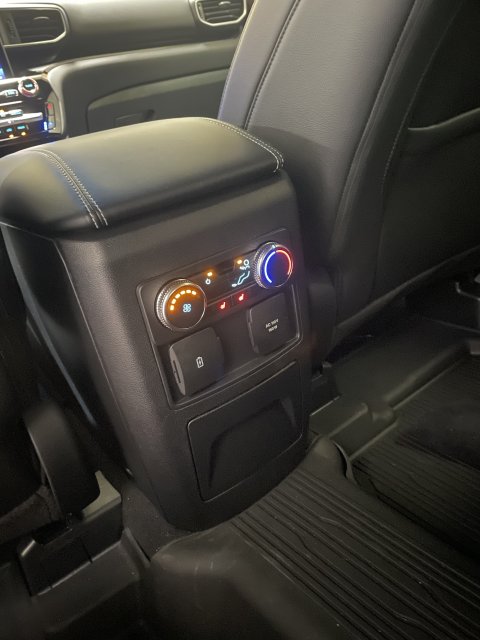

Today I installed the 3rd zone climate control and rear heated seats module. My truck is a 2022 and it was built without the controls. I along with everyone else was credited for the removal. Installation was super easy and took around 10 mins to complete. The rear seats have the elements and all wiring installed and the rear centre console where the module is located has the wiring taped that controls the settings. Pics are included here, along with the part number for the controls. I bought the control unit from Camelback Ford in Arizona. They had it in stock, but only this one.

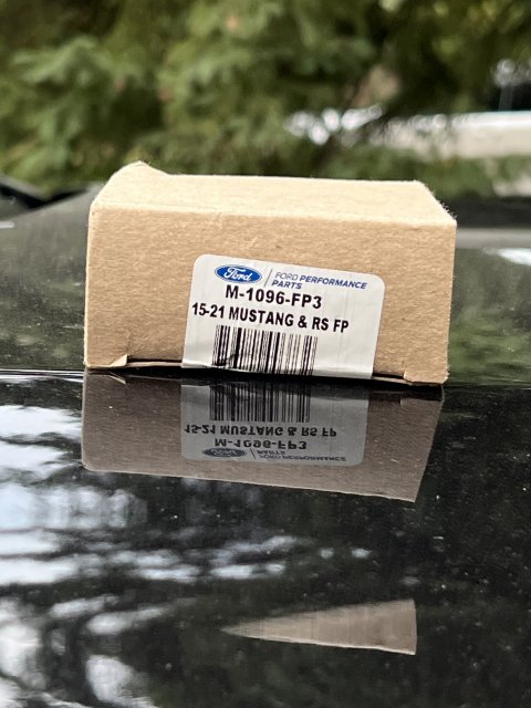

Added Ford Performance wheel center caps. Included is a pic of the box showing the part number for those that are interested.

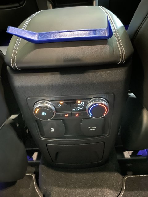

You have to open the arm rest lid and put a pry tool between the cover where the control module comes through and pry towards the back of the vehicle. It is held on by 6 clips, 3 on each side. Once the panel pulls away from the console, use your fingers to pull rearwards.
@JDHRNC, Very nice, I did a quick check on these, $50/ea.? Actually I saw these for $39. CJ Pony Parts was showing these as individual units. Didn't seem right.
I bought them from Late Model Restoration and paid $42.99 each for them. I’ve bought stuff from CJ Pony Parts before and they’re good to deal with also.

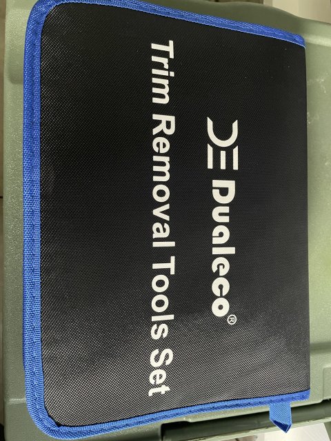

Purchased this trim kit from Amazon and installed the second row HVAC, seat heater control. Very easy to do. The blue color trim tool is the one I used to safely remove the panel cover. Thanks JDHRNC. 1D62565A-FB14-4293-8319-19E621905DF0.jpeg 017B437F-7918-45FC-9DF8-587D9549F98B.jpeg 91B6071E-1E01-4037-984E-AE416A3D841A.jpeg
