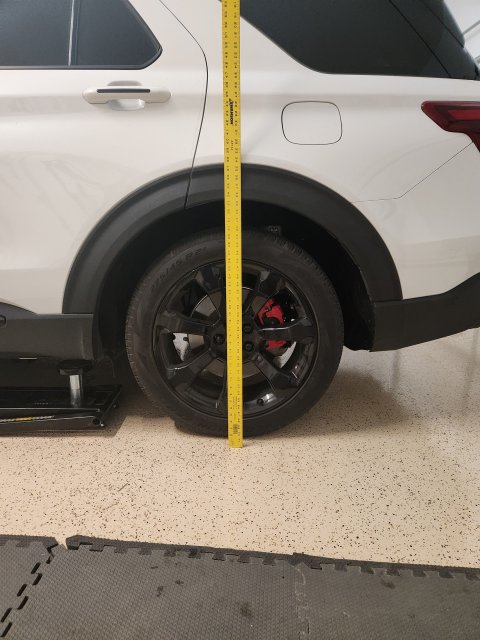

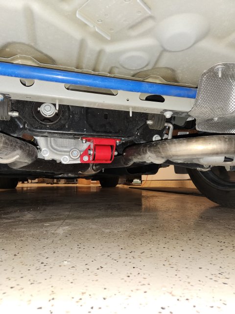

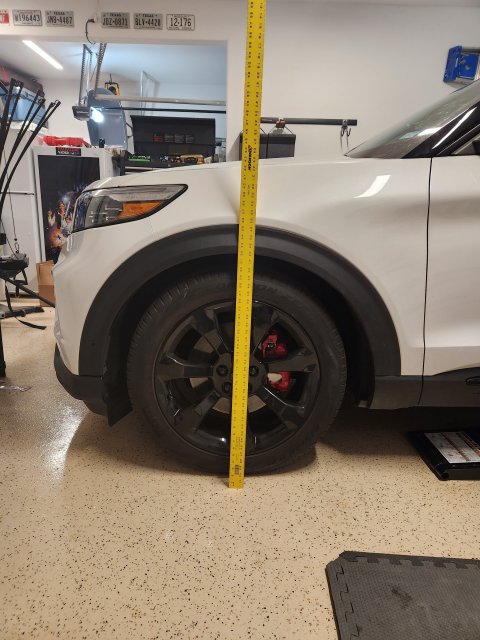

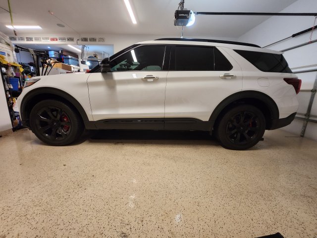

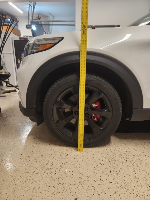

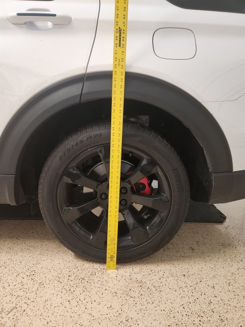

Installed Lethal Performance springs and AWR diff brace. Before and after pics on springs.

Kind of interesting that after 2 years, my Steeda's are lower than that. Measure about 31 3/4" in front and 32 3/4" in back (to the wheel arch)

I did expect it to be lower, especially in the rear, but really pleased with the look and the ride quality is better than the stock springs. Maybe they will settle some more as time passes.

Floor to arch isn't good to compare car to car. Gotta measure from the center of the wheel to the arch to compare car to car; eliminates wheel and tire variables.
