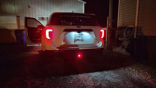

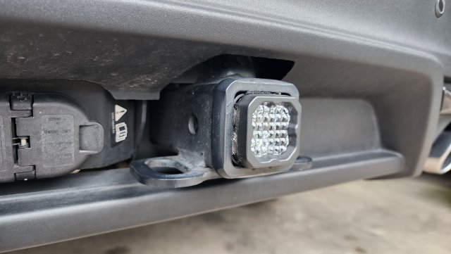

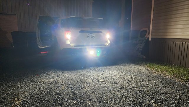

My Diode Dynamics Hitch Reverse light came in today. Super impressed! Probably gonna unpin the wire for the running light so it only functions in reverse.
That’s super cool! I had read elsewhere in here that it wasn’t possible to make a hitch light work with the stock wiring for some reason. I guess that was wrong.
If its got a standard 7pin round hitch plug it works perfect. Plugs right in, took 2 minutes!
DD7420 is the part number
You get the trailer attached warning every time you start the car?

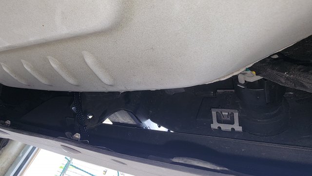

Given my limited abilities, I crawled under to survey the situation. Installing the wiring harness will be a cinch with one potential issue. At least on my 2021, there appears to be very little space between the rear of the trailer hitch and the spare tire pan. I wonder whether there’s enough room to pass the cable (with the orange connector) into the rear of the hitch.
Did you encounter such a limited space?
Mine is also a 2021, there is just enough room to get it in there. I just used a small pick hook to fish the wire through the hitch, tie wrapped the excess wire to a lenght just enough to unplug it. I did put some felt in around it to snug up the fit.
