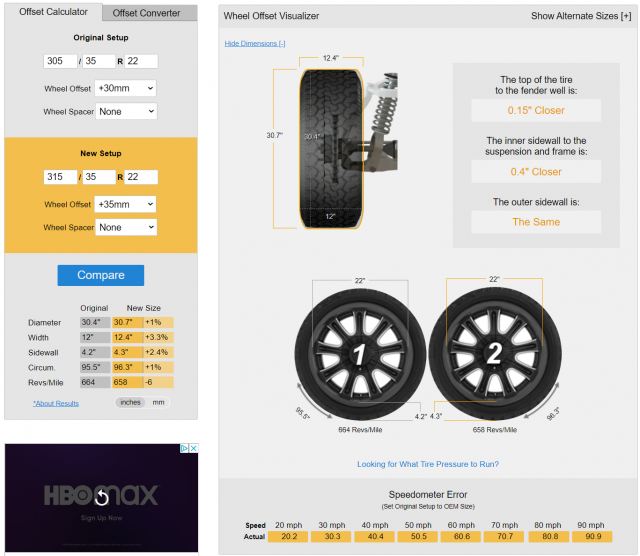

Do you believe 22x11 with +35 offset with 315/35/22 tires will clear without any rubbing or sticking outside the fenders ?
Versus the OE 21" setup, with your setup the wheel would extend out on the outside just over an inch (about 28mm) and inside would be around 3/4" closer to the struts (about 22mm). So it would hang outside the fender a touch in the rear and a bit more in the front. As far as rubbing, I can't say, overall OD is good but it sounds like it is going to be a bit close to the strut.

It won’t stick out that far at that width and offset. About 3mm further than a +30 10.5 which is dead flush up front. The rear fitment can be made the same by setting rear camber at -.5*
A +35 11” wheel would be inside the rear fender at oem alignment specs.

Ok so it would clear the inside suspension ? since it will be in a little more than your setup?

Like I posted it would be very close. Too close for comfort for me especially considering tires don’t run a consistent width regardless of the size so there’s no way to account for the true amount of tire bulge.

Whoops, yeh there's about 30mm clearance from the OE rears and fenders, so it would NOT stick out a touch with that extra 28mm of the +35 11" wheel, I was wrong there.

The front wheel would stick out about 3 mm. The rear wheel would be under the fender. This isn’t taking any tire bulge into account.

I don't have mine on just yet, but have no doubt my setup will work without any problems or rubbing. This setup has been tested by many others here already and one member himself worked with BC Forged to take measurements for proper clearance with the most aggressive stance out to the fenders. There are plenty of sites that can help with showing how much of a difference going from one tire to another impacts your setup. Here is an example visually showing the difference you are looking for:
I believe others may have confirmed a 315 is possible on my setup but with the increase wheel width and offset change you requested it would be 0.4" closer to the suspension and frame... without having them on, I couldn't tell you how much wiggle room there is. With that said the 315/35/22 is a perfect +1 setup from an overall total diameter size which means 0 impact to speedometer and odometer readings. I see our resident wheel expert @UNBROKEN has chimed in and I would defer to his recommendations.

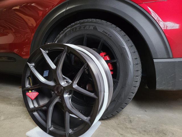

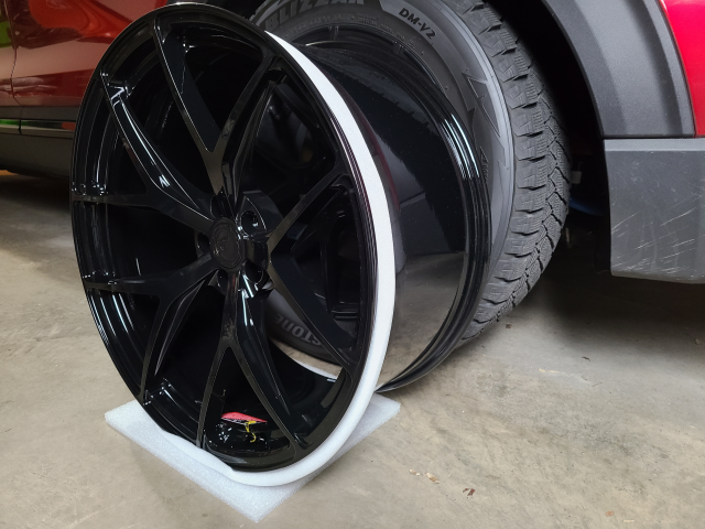

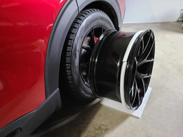

Going to get the wheels ceramic coated tomorrow. In loading up the car I took one out and placed it next to the ST. Love the Gloss Black on these wheels! In case anyone wants to go with a Brushed Dark Black finish on a Rapid Red, I put one from my other car (these are only 20" in a slightly different style) next to the ST.

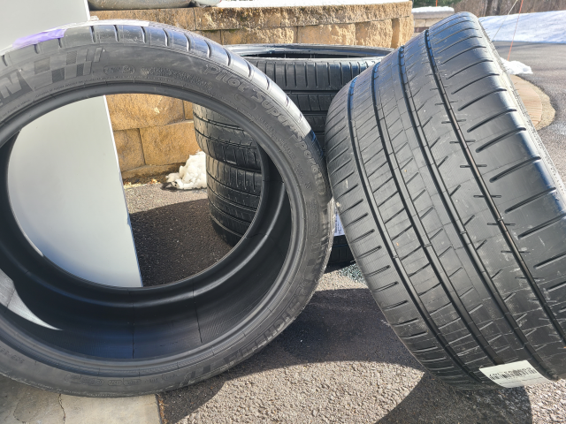

But you will probably have them mounted before me. I need to get the tires mounted and balanced... then setup a visit to get them ceramic coated before they are ready for the ST.
