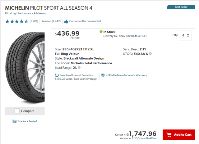

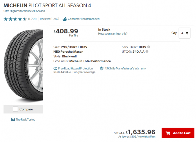

I ordered 275/40/21 but now I'm looking at these 295/35/21
1. Will they fit?
2. Is a 275 vs.295 noticeable for the extra $100+/tire?
4,880
5,821
#31
That tire is way too short. Look at a 295/40 instead.

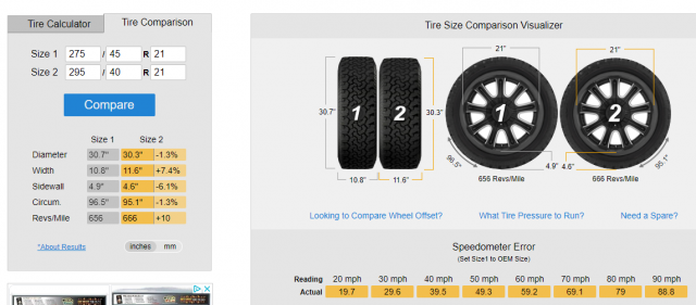

#33
The difference in diameter of the 275/40/21 vs 295/35/21 is 13.5mm smaller on the 295/35/21. with the 295/40/21 it is 16mm larger than the 275/40/21.
