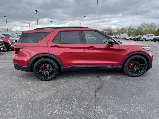

That will work. I have had that wheel size and tire size together with zero issues. Went to 295/40/22 for a little more sidewall. Some wheels look better than others with the lower profile 305/35/22 tires.
Car looks awesome. What rim did you end up with?

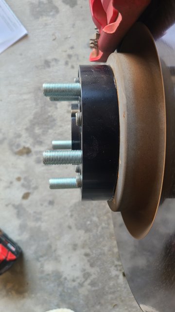

I received my spacers yesterday and checked fitment. Looks like .25" will have to be cut off factory studs. At least that's how much the stud protrudes out of the spacer. Please let me know about the tire fitment though. From what I've read in this thread is as long as it's smaller then a 1.5" spacer we should be good.
Some wheels have indents in the back that allow the studs to protrude a little. Have a look first.

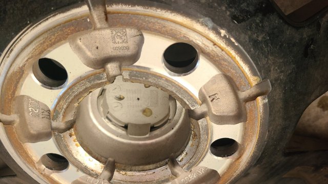

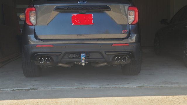

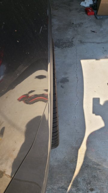

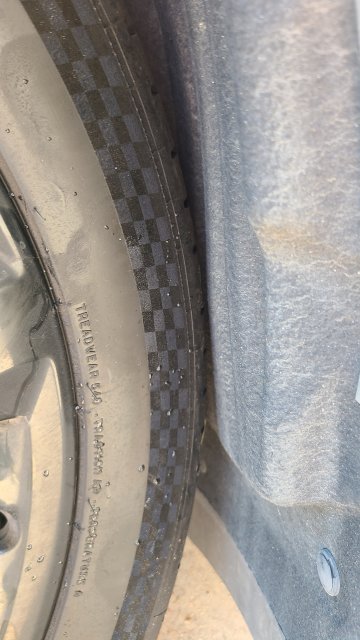

Here is my update. The stock studs do extend past the 1.25" spacers, but the wheels do have indents as stated by @Big Turk to accommodate that. With the front wheels at full lock, there is very little space between the front of the fender well and tire, but no rub. The back side of the tire has plenty of room. The wheels do extend a bit past the edge of the fenders. I haven't noticed any significant change in handling, certainly not anything detrimental. I think it looks great, but I'll have to see how things are when we start getting rain again.
Studs.jpg Wheel back.jpg Fender Well.jpg Top Front.jpg Top Rear.jpg Front.jpg Rear2.jpg Rear.jpg

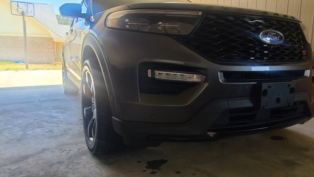

#57
Here is one I grabbed a minute ago. If you want a different angle, I can post another after work.
I like that!! Wonder how this would look with 1.25" spacer in the rear?
