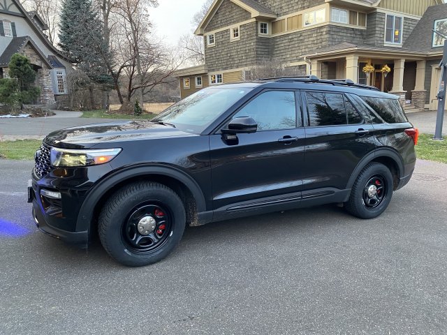

Sorry I should have reported back…
Yes the original lug nuts seem to work just fine and the center cap has a nice snug fit. 588B533E-55FF-47D9-8429-B1B473B3F2DE.jpeg

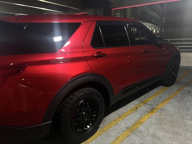

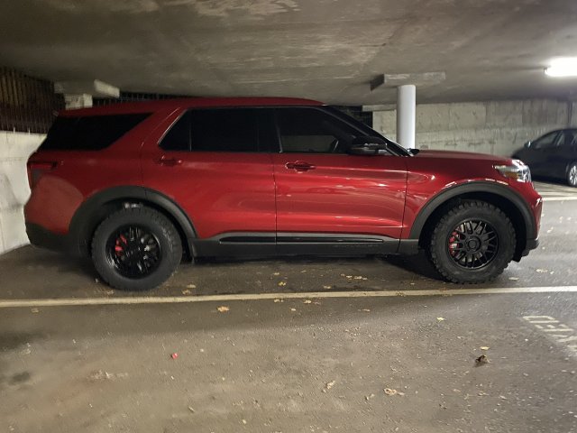

79FE06BA-A666-4850-AD54-D5B2805139B3.jpeg 8DF8E15F-E4C8-4A80-AFC9-D9D752150B3F.jpeg
I’ve been running 265/60/18 BF GOODRICH KO2s on 18X8.5 MOTEGI M9 5X114.3 +35 this whole year. Loved them. They made driving in snow and ice predictable and fun. Expensive trial but I think I’d do it again but next time with a quieter A/T.
