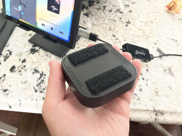

FYI the carlinkit T box is passing along media info from android OS as well as wireless CarPlay perfectly after the latest update.
It was listed in the change log that they got it working and I just tested it and it’s functioning perfectly. 5/4/2023 version of OS can be found here:
https://www.carlinkit.com/download.html
Unzip file password is “chel” You have to unzip the zip file within the first zip (even though it tells you you don’t)
